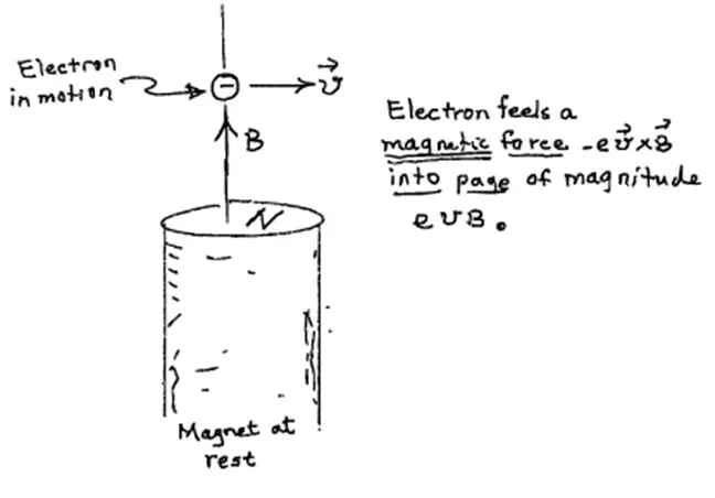

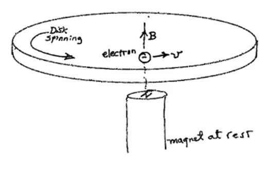

Suppose the disk is spinning in the lab frame of reference, and the magnet is at rest.
The free electron shown inside the disk is moving toward the right in the upward magnetic field of the magnet. The electron of charge ##-e## experiences a magnetic force ##evB## toward the center of the disk, or into the page in the picture below.

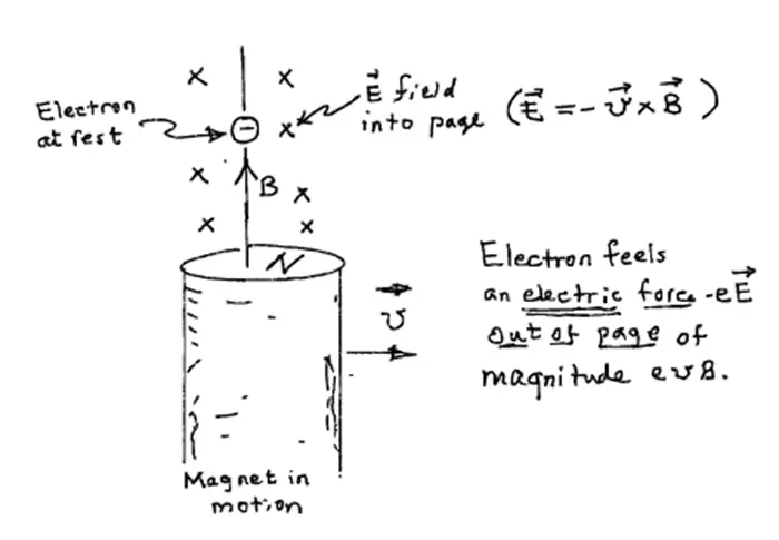

Next, suppose the disk is not spinning but the magnet is moving toward the right with speed ##v##. In the lab frame of reference, the moving magnet produces an electric field into the page at the location of the electron. The magnetic field of the magnet does not produce a force on the electron when the electron is at rest.
The magnitude of the electric field is related to the magnitude of the magnetic field and the speed of the magnet. Assuming ##v## is much smaller than the speed of light, it can be shown that the magnitude of this electric field is ##vB##. So, the electron experiences an electric force out of the page of magnitude ##evB##. This force tends to drive the electron out toward the rim of the disk.

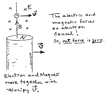

Finally, suppose the disk is spinning and the magnet is moving with the disk.
In the lab frame of reference, the electron experiences a magnetic force ##evB## into the page and an electric force ##evB## out of the page. The two forces cancel, so the net force on the electron is zero.
In a frame of reference moving with the electron and magnet, the electron and magnet are at rest. In this "comoving" frame, there is no electric force on the electron and no magnetic force on the electron. So, observers in the lab and comoving frames agree that the net force on the electron is zero.
