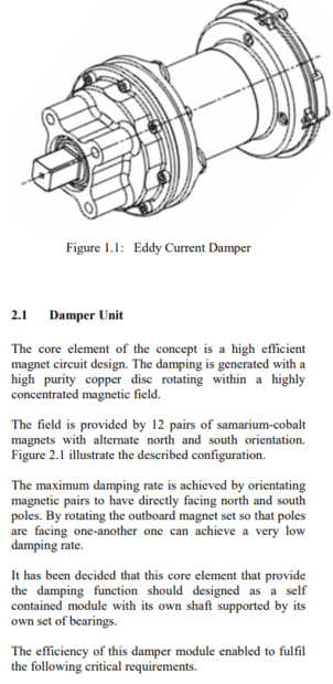

For reference, this is a paper about the Eddy Current Damper I would like to study first.
I think these components are very well suited for space applications because the fluid counterpart might not be as convenient when dealing with vacuum and temperature changes among other potential problems. These ECDs (Eddy Current Damper) don't need wires coming out or anything like that. They are a complete and passive unit that will produce a damping force mainly proportional to the velocity. Frictional forces due to sliding friction are still there because big gear ratios are typically necessary to amplify the effects of the damper and said gear ratios will amplify the friction too. It's not great but it's something that can be dealt with as long as it is taken into account by having proper actuation margins.

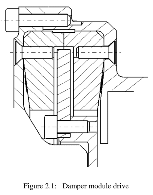

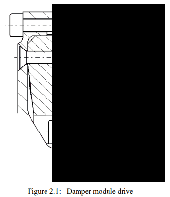

First of all, the magnet configuration. The paper mentions the magnet configuration but hides the picture for some reason.
Cutaway line drawing of an eddy current damper unit: a cylindrical housing with a square drive shaft at the left end, a rotating copper disc and a ring of magnets around it.
Cross-section drawing of a damper module drive showing a socket-head bolt, a hatched body with a tapered outer profile, and a bore, labelled Figure 2.1: Damper module drive.

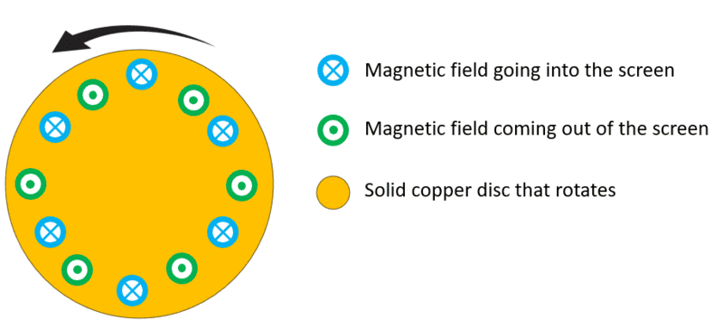

According to what I read in the document, I believe it is a magnetic axial flux configuration with a rotating copper disc as shown in the following picture.
Diagram of a solid copper disc rotating counterclockwise, with an arrow on top, surrounded by a ring of alternating magnetic field symbols: blue circles with crosses for field into the screen and green circles with dots for field out of the screen.
From what I learned in the previous post, the poles must be alternating. Otherwise, it'd be closer to a Faraday Disc which would not produce much damping if the circuit is not closed (even when closed it might not be ideal because of the Faraday Disc Paradox but that's a whole other issue not worth getting into now). With an open circuit (outer radius and shaft are disconnected) and all field lines oriented in the same way, the charges would bunch up at the outer radius and center depending on the magnetic field orientation. On the other hand, an alternating magnet configuration as shown would produce eddy currents that would dissipate the energy because the charges would constantly try to move to the outer radius and then back to the center when they face the opposite magnetic field. Is that reasoning correct?

Huh... That's so weird. I use Chrome. I would have not expected compatibility issues with a PDF file. But once downloaded it and opened it with Acrobat I could visualize the document just fine. I thought that picture got redacted for some confidentiality issues.

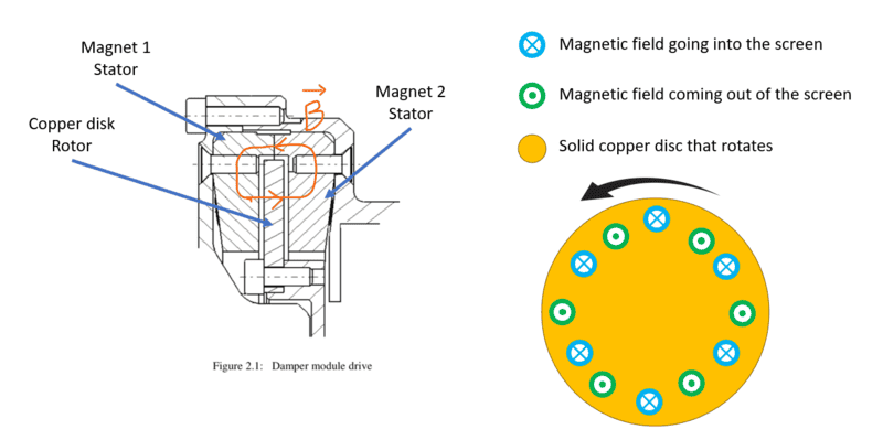

I added some notes to the drawing.
Left: cross-section diagram of a damper module drive labelled Magnet 1 Stator, Magnet 2 Stator and Copper disk Rotor, with orange flux loops. Right: annotated copper disc with blue and green circles showing field into and out of the screen.
Do you think that's a correct interpretation of the mechanism? Depending of which section is studied (12 different sections), the magnetic field would be pointing one way or the other.
Do you have any comments about the rest of the points raised in the original post?
Eddy current brakes were once controlled electrically by changing the current through the electromagnets.
The design with permanent magnets, to control the magnetic braking, rotates one stator magnet plate by one pole against the other. Your diagram shows maximum braking, when all upper and lower poles reinforce.

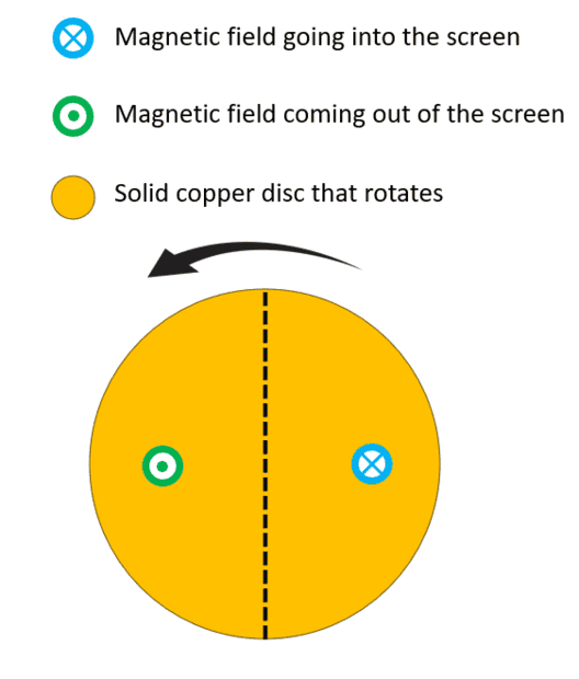

In this case, the net change in magnetic flux is 0 because all the incoming flux on one side will be negated on the other. To simplify the previous picture, consider an arrangement with only two constant magnetic fields.
Diagram of a solid copper disc rotating counterclockwise, with a dashed line through its centre and two magnetic field symbols: a blue circle with a cross for field going into the screen on the right and a green circle with a dot for field coming out of the screen on the left. A key at the top defines the symbols.
It makes sense that such an arrangement has a net change in flux being zero ##\frac{d\Phi_m}{dt}=0## because it's not a generator. But I know eddy currents will be produced and dissipate energy. That's the whole point of an eddy current damper. I believe the currents will behave as mentioned in the OP.
