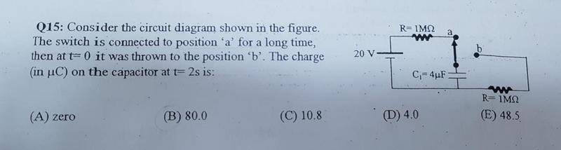

When the switch is connected to position a :
20-106 * I = 0 ( KVL)
Vc = 0 , because the switch is connected for a long time.
I = 2*10-5 A
When the switch is connected to position b :
Q/(4*10-6) - 106 *2*10-5 = 0 (KVL)
Q =8*10-5 = 80μC
Is my answer correct ?
Are you sure?
No, t=2s doesn't appear anywhere in your equations.
cnh1995 said:
Are you sure?
