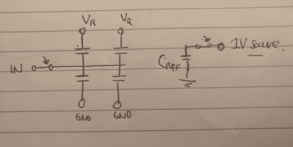

I have a question relating DAC architectures. The guts of the question are really to do with capacitors and charge. I want to see if my understanding is correct. This is not a homework question or anything, just thinking about how the circuit interacts.
Setup:
Consider the following setup:
Hand-drawn schematic of a capacitor bank with C1 and C2 at 32 fF and C3 and C4 at 16 fF, tops joined, bottoms to Vr or GND, input switch at left, and a 1V reference capacitor at right.
Capacitors C1, C2, C3, C4 where C1 = C2 = 32fF and C3 = C4 = 16fF. All the capacitors in the bank have their top/positive plate connected together. The bottom plate of C1 and C3 is connected to a reference capacitor which is charged to 1V initially (Vr node). The bottom plate of C2 and C4 is connected to GND. There is also an input switch used to sample a voltage onto the top plates of each capacitor.
Step 1 - Sampling:
Hand-drawn schematic of a capacitor bank: two columns of capacitors with top plates joined to an IN switch, one column's bottom plates tied to VR and GND, the other column's bottom plates tied to VR and GND.
The input switch is closed and the top plates of the capacitors now move with the input voltage (let's say some sinusoid)

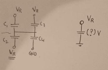

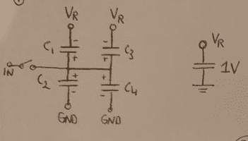

Here come's the tricky part. Let us now switch the bottom plate of capacitor C2 from GND to Vr.
Hand-drawn circuit schematic of a capacitor bank with C1 and C2 on the left, C3 and C4 on the right, top plates joined by a horizontal wire, bottom plates tied to VR or GND, plus a separate VR node with a capacitor labelled (?) V to ground.
Here is my understanding of what happens now:
  1. C2 bottom plate goes from GND to Vr
  2. To ensure that the voltage/hence charge on C2 remains constant, the top plate of C2 must move to Vip + Vr. Just like in a Dickson charge-pump.
  3. Since the top plate of C2 is at Vip + Vr, but the top plates of C1, C3, C4 were still at Vip, charge redistribution occurs.
  4. As part of the charge redistribution process, current (positive charge) flows from the top plate of C2 to the top plates of C1, C3 and C4. The voltage at the common node of all capacitors settles at a steady-state voltage somewhere near Vip + 0.5Vr (I know it can be calculated.)
Here is my question - what happens to the refernece voltage Vr which was on a capacitor?
My guess is that:
  • During the charge redistribution process, positive charge had to leave the top plate of C2 to equalise the potential with other capacitors.
  • Since +Q (positive charge on positive plate) decreased on C2, then -Q (negative charge on negative plate) must also decrease.
  • Thus, electrons flow to the Vr capacitor, thus current leaves Vr capacitor and hence voltage on Vr decreases!
That's one argument. The other argument is that
  • During the charge redistributon process, the positive charge (+Q) gained on the top plates of C1, C3, C4 means that (-Q) charge on bottom plates of C1, C3, and C4 must increase.
  • Thus, electrons flow to the bottom plates of C1, C3, C4 from the reference capacitor, hence current flows to the reference capacitor. Thus, the reference capacitor voltage Vr increases!
These two statements are contradictory. Where is the flaw in my understanding?

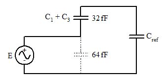

Much will depend upon the capacitance value of your reference capacitor. A ginormous capacitance (with respect to the other capacitors) will make changes in voltage cross it insignificant. On the other hand, if it's a similar magnitude of capacitance then there will be some details to consider.
If we combine the two upper capacitors (since they never get rearranged) they become a single 32 fF cap. While the circuit is being driven by the input signal this cap forms a voltage divider with your ##C_{ref}##:
Circuit schematic with an AC voltage source E on the left, a 32 fF capacitor labeled C1 + C3 on the top branch, a 64 fF capacitor on the lower branch, and a capacitor labeled Cref on the right side.
The voltage on the lower caps, represented by their sum of 64 fF, is directly driven by ##E##. so it can be ignored here.
You can then see how the voltage on ##C_{ref}## will vary while the circuit is being driven by the input. Clearly, if ##C_{ref}## is huge compared to ##C_1 + C_3## the fluctuation will be minuscule.
If we take an example value of ##C_{ref} = 10 \, \mu F## then the variations on the ##V_{ref}## will have a magnitude of:
##\Delta V_{ref} = E \frac{32 \times 10^{-15}}{32 \times 10^{-15} + 10 \times 10^{-6}} = 3.2 \times 10^{-9} \times |E|##
Assuming that ##|E|## is reasonable you can ignore changes while the circuit is being driven.
After the "switch" of ##C_2##, if ##C_{ref}## is still assumed huge by comparison, it should effectively maintain it's original voltage.

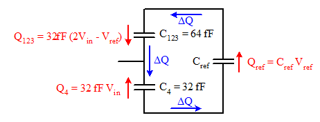

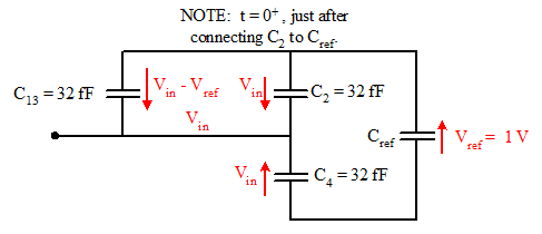

In your second scenario you seem to be having electrons coming out of both the top and bottom of the reference capacitor (my assumption is that the "top plates" for C1 though C4 are all connected together at the sampling node). That cannot be true.
Here's a diagram show what I think the circuit will look like in the instant before charge distribution happens. I've combined C1 and C3 into a single capacitor C13. The red arrows represent the voltage orientation on the capacitors (arrow points to positive plates).
Circuit schematic just after t = 0+ with C2 connected to Cref: C13 = 32 fF and C2 = 32 fF share the top node, C4 = 32 fF connects below C2, and Cref has Vref = 1 V, with red polarity arrows marking Vin - Vref, Vin and Vin.
C13 and C2 are in parallel and of the same size. We can combine them into a single capacitor C123 = 64 fF holding the sum of their charges. That gives us:
Circuit diagram of a capacitor network: C123 = 64 fF and C4 = 32 fF in parallel on a common node, with Cref on the right. Charges labelled Q123 = 32 fF (2Vin - Vref), Q4 = 32 fF Vin, and Qref = Cref Vref, with ΔQ arrows marked on the wires.
Where the charges on the capacitors are shown. The red arrows still represent the voltage polarities. Some ##\Delta Q## will leave the reference capacitor. I use conventional current, so this represents the flow of positive charges.
Solve for ##\Delta Q## for a given value of reference capacitor, then you'll be able to see how the voltage on that capacitor changes during charge redistribution.

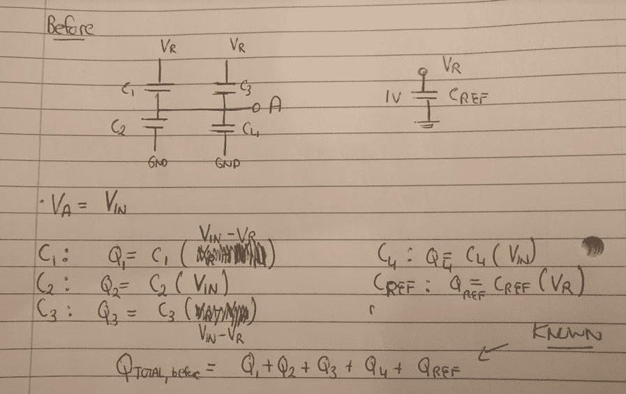

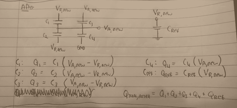

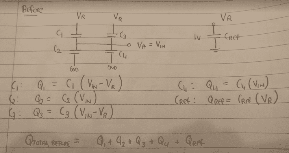

Thank you for the detailed response. I'm having a hard time following that. In your analysis, Vref is a variable which I understand because charge redistribution will have an effect on it, however Vin is kept constant on the top plates of the capcaitors?
During charge redistrbution, Vin is no longer connected to the top plates, and it should change the voltage on capacitor top plates.
Currently, I'm analysing it in a before and after state. Before charge redistribution, I know all capacitors have Vin on top plates and Vr is constant at 1V, thus I know the charge on every capacitor.
Then I consider the state after charge redistribution has occurred. In this state, Vr is an unknown and so is the capacitor top plate voltage. So in this state I have two unknowns.
I then equate the before and after charges (conservation of charge), but I am left with 1 equation with 2 unknowns - capacitor top plate voltage and Vr - the reference voltage.

You'll need to show the work you've done in detail. You may be making things difficult for yourself by choosing a less than optimal strategy, but I can't tell from what you've described so far; I need to see the details of your attempt.

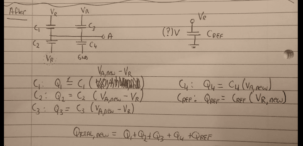

Handwritten circuit diagram labelled Before, showing capacitors C1, C2, C3 and C4 with VR sources, node A, a CREF capacitor to ground at 1V, and charge equations Q1 to Q4 plus QREF with the total charge QTOTAL before written below.
Handwritten notes on lined paper labelled After: a circuit of capacitors C1 to C4 and CREF with nodes VR, VR, GND and A, followed by charge equations Q1 to Q4, QREF and QTOTAL,new in terms of VA,new and VR,new.
Handwritten equation Q_TOTAL, before = Q_TOTAL, new, followed by the line Solve for V_A,new and V_R,new.

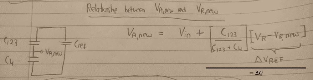

Yep. It looks like you're going the long way around. I don't think that you can sum the charges in the way that your doing and hope for conservation of charge. When charge redistribution occurs, some + charges will cancel some - charges.
If you look at the reduced circuit diagram that I provided previously:
Circuit schematic of a reduced capacitor network: C123 = 64 fF and C4 = 32 fF in parallel with Cref, with charge labels Q123 = 32 fF (2Vin - Vref), Q4 = 32 fF Vin, and Qref = Cref Vref, and ΔQ arrows marked on the branches.
you should be able to write a KVL equation that reflects how the ##\Delta Q## that leaves the reference capacitor will balance the equation. ##\Delta Q## is going to reduce the potential across ##C_{ref}## and ##C_{123}## while it will increase the potential across ##C_4##. One equation, one unknown (##\Delta Q##).
Once you have ##\Delta Q## you can find the final potentials across all of the capacitors.

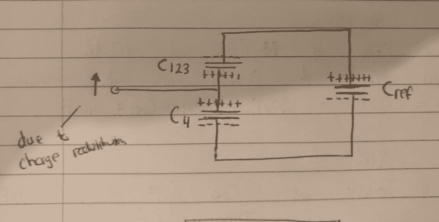

Hmm. I see. However, how do you have only 1 unknown. The Vin voltage on the central node (top plates of capacitors) will also change and so will Vref. Hence, don't you have two unknowns?
Also, I'm a bit confused about this circuit when I think in terms of +Q and -Q charge.
Handwritten circuit sketch of a capacitor bank: C123 and C4 stacked in series with a central node, Cref on the right connected across the bottom, with plus and minus charge symbols on the plates and a wire labelled "due to charge redistribution" pointing up to a node.
For example, if the central (top plate) node increases in voltage, the Q = CV for C123 will increase, thus it now has more charge on it's + plate and hence requires a higher number of - charge on it's bottom plate. The bottom plate of C123 is connected to Cref, so positive charge must flow from C123 bottom plate to top plate of Cref -> thereby increasing the voltage on Cref, not decreasing?
I have only one unknown because I'm only looking for the net charge that ##C_{ref}## needs to lose in order for the circuit to balance KVL. I have some initial potentials across all the capacitors (hence charge is known on them), and I'm "pushing" some quantity of charge onto each of them, hence changing their individual potential differences. With the right quantity of ##\Delta Q##, KVL will be satisfied.
If you check your initial conditions you'll find that ##V{ref}## is greater than the sum of the potential across ##C_{123}## and ##C_4##. So charge will flow from the top of ##C_{ref}## to the other components. This will have the effect of decreasing the total charge on ##C_{123}## while increasing the charge on ##C_4##.
##C_{123}##'s voltage will decrease while ##C_4##'s will increase. The ##\Delta Q## determines the amount that each decrease or increase. One equation, one unknown (##\Delta Q##).

I just had a thought. Can I still use the law of charge conservation like before but instead do it like this:
Handwritten 'Before' circuit diagram of a capacitor DAC: C1, C2, C3, C4 and Cref with supply VR, node VA = VIN, and the charge equations Q1 = C1(VIN - VR), Q2 = C2(VIN), Q3 = C3(VIN - VR), Q4 = C4(VIN), Qref = Cref(VR), and Qtotal before = Q1 + Q2 + Q3 + Q4 + Qref.
Handwritten circuit sketch labeled After, showing capacitors C1 to C4 and CREF with node voltages VA,new, VR,new and GND, followed by charge equations Q1 to Q4, QREF and QTOTAL,AFTER.
Here is the new part, I relate the new central node voltage with the charge left from the reference capcaitor:
Handwritten note titled "Relationship between VA,new and VR,new" showing a circuit of capacitors C123, C4 and Cref with node VA,new, and the equation VA,new = Vin + [C123/(C123 + C4)][VR - VR,new] with the bracketed term labelled ΔVREF, equal to ΔQ.
And now, I equate the two - charge before and charge after and substitute in this relationship, which gives me one equation and one unknown.
Handwritten notes on lined paper: Q_TOTAL, BEFORE = Q_TOTAL, AFTER, with 'using relationship' written beside it, then an arrow to 'One equation, one unknown'.
  • Handwritten note titled Relationship between VA,new and VR,new, with a circuit sketch of capacitors C123 and C4 in series at node VA,new in parallel with Cref, and the equation VA,new = Vin + [C123/(C123 + C4)][VR - VR,new], where the bracketed term is labelled ΔVREF.

Well, you can try it and find out if the result matches doing it via KVL. I wrote a KVL equation for the loop:
##\left( V_{ref} - \frac{\Delta Q}{C_{ref}} \right)
+ \left( V_{123} - \frac{\Delta Q}{C_{123}} \right)
- \left( V_{in} + \frac{\Delta Q}{C_{4}} \right) = 0 ##
and solved for ##\Delta Q##.
Why is V123 = 2Vin - Vref? I understand the Vin-Vref voltage is what capacitors C1 and C3 had in the start and after.
I also understand that as soon as you switch (at time t = t0+), that capacitor C2 still has voltage Vin across it, yet it is now in parallel with C1 and C3.
Why are you adding that Vin voltage that C2 had with the voltages across C1 and C3. Seems a bit difficult to understand, since they are all in parallel, so all should same voltage in steady-state.
I understand this isn't steady state, but what's the intuition behind adding them the voltage that C2 had before the switch (Vin) with the voltages that C1 and C3 had before the switch (Vin - Vref)?
It isn't. The charge on C123 is given by ##Q_{123} = 32 fF \left(2 V_{in} - V_{ref} \right)##.
Keep in mind that the size of this capacitor is ##C_{123} = 64 fF##...
