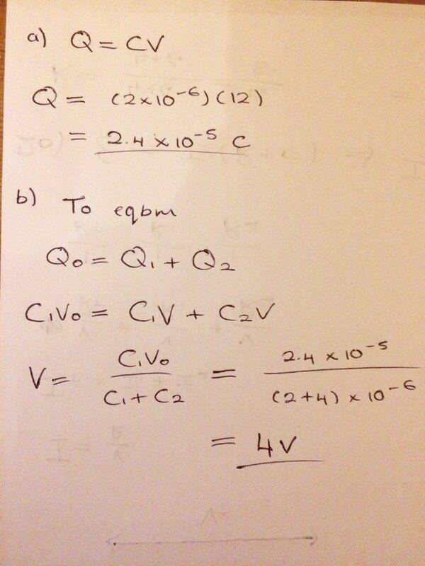

The discussion centers on the behavior of capacitors when a charged capacitor is connected to an uncharged capacitor. Specifically, a 4 μF capacitor is connected to a 2 μF capacitor, leading to a redistribution of charge. The conclusion drawn is that the total charge is shared among the capacitors, resulting in each capacitor being charged to one-third of the voltage required for the 2 μF capacitor alone. This intuitive approach simplifies the understanding of charge distribution in capacitors in parallel.
