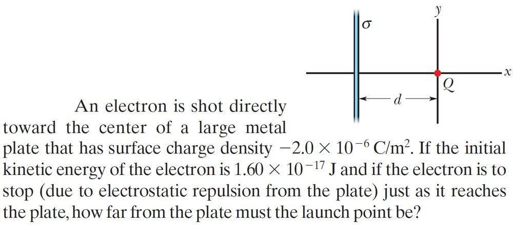

An electron is shot directly toward the center of a large metal plate that has surface charge density sigma. If the initial kinetic energy of the electron is known and if the electron is to stop (due to electrostatic repulsion from the plate) just as it reaches the plate, how far from the plate must the launch point be?
E=sigma/a/epsilon_0
The solution to this problem states the electric field is E=σ/ε0. Is that because it's a conducting plate? I know for a non-conducting plate it's E=σ/2ε0. This is a Gauss' Law problem. I know how to derive for non-conducting plate. What's different with conducting plate derivation? Thank you!

For a non-conducting plate, there need not be any other charge on it, but for a conducting plate there is necessarily an equal charge on the further surface.
One thing bothers me about this question, though: as the electron approaches the plate, the charges on the plate will redistribute.

For a conducting plate in electrostatic equilibrium such as the metal one in your problem, the electric field indeed is ##\sigma /\epsilon_0##. To derive this, one crucial thing has to be considered-- the electric field inside of a conductor in electrostatic equilibrium is zero (hopefully you know the qualitative argument as to why this is!) Set up a Gaussian cylinder with surface area of the faces each being A, and have one end of the cylinder be inside the conductor and the other outside (this is the same Gaussian surface used in the non-conducting plate derivation). Using the crucial fact mentioned above, do you see where you lose that factor of 2 in the denominator of ##\sigma /2\epsilon_0##?
