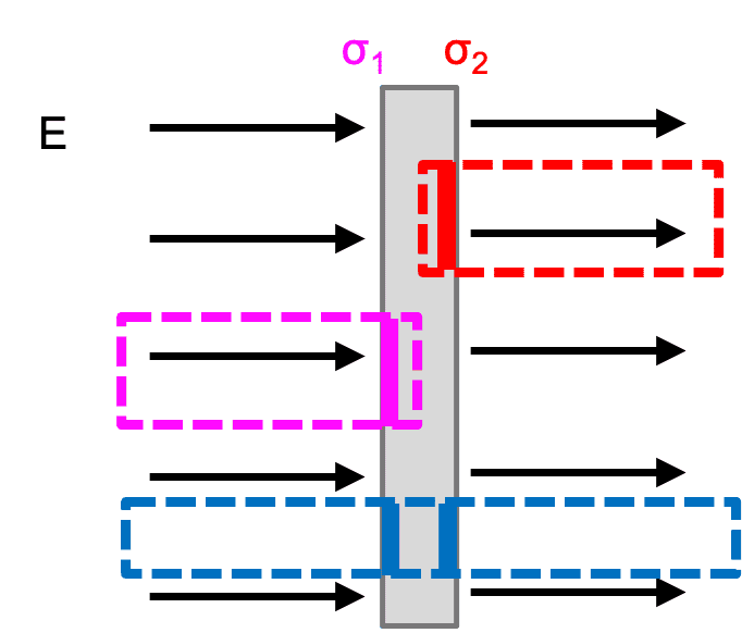

A square plate of copper with 0.5m sides has no net charge and is placed in a region of uniform electric field of 80000##\frac{V}{m}## directed perpendicularly to the plate. Find the charge density and total charge on each face.
The total charge can be found using Gauss's law by imagining a box passing through both sides of the sheet. $$2EA=2E(0.5m)^{2}=\frac{Q_{total}}{\varepsilon_{0}}\rightarrow Q_{total}=354nC\rightarrow Q_{side}=177nC$$
And of course, the charge density on each face is just the charge on each face divided by the area, yielding 708##\frac{nC}{m^{2}}##.
Great, this all makes sense. But here's the point of confusion. The electric field near the surface of a conductor is ##\frac{\sigma}{\varepsilon_{0}}##. As I've read online, this is because the charge on a conductor resides on the surface (which I completely agree), and thus only one surface contains all the charge. In other words, ##EA=\frac{Q_{enc}}{\varepsilon_{0}}## which yields the previous equation. Simply draw a Gaussian surface that goes from somewhere inside the conducting sheet to the outside to get the EA. See here and here.
However, this directly contradicts the prior intuition I've developed since ##\frac{\sigma}{2\varepsilon_{0}}## should hold valid near a conducting sheet. I think the problem is where the charge resides on the conducting sheet. It must reside on both faces since the faces are the surfaces. Indeed, my solution to the example problem is correct and makes this assumption. However, the first link that includes a video dictates that the charge on the other face is zero because it is not a surface...but it clearly is a surface?

It's the total charge on each face. Doesn't charge redistribute when placed in an electric field?
You solved your example problem incorrectly. If it has no net charge, how can it have a total charge of 354 nC with 177 nC on each side?
Consider the conducting sheet in an external electric field. The electric field inside the conductor is zero. Consider the picture below. The left face has charge distribution ##\sigma_1## (magenta) and the right face ##\sigma_2## (red). There are three Gaussian pillboxes, red, magenta and blue. Write Gauss's law for each one of them and see what you can say about the charge distributions.
For the red: $$\oint_{S}\textbf{E}\cdot d^{2}\textbf{r}=EA=\frac{q_{2}}{\varepsilon_{0}}$$
For the magenta: $$\oint_{S}\textbf{E}\cdot d^{2}\textbf{r}=EA=\frac{q_{1}}{\varepsilon_{0}}$$
For the blue: $$\oint_{S}\textbf{E}\cdot d^{2}\textbf{r}=E2A=\frac{q_{1}+q_{2}}{\varepsilon_{0}}$$
Which yields ##E_{red}=\frac{\sigma_{1}}{\varepsilon_{0}}##, ##E_{magenta}=\frac{\sigma_{2}}{\varepsilon_{0}}## and ##E_{blue}=\frac{q_{1}+q_{2}}{2A\varepsilon_{0}}=\frac{0.5\sigma_{1}+0.5\sigma_{2}}{\varepsilon_{0}}## respectively.
So if the charge distributions are identical on each side, ##\sigma## is identical? I don't really see how I could get ##\frac{\sigma}{\varepsilon_{0}}## versus ##\frac{\sigma}{2\varepsilon_{0}}##.

But your method was completely invalid. Your Gaussian box passed
so should have contained zero net charge, but somehow you arrived at 354nC, a charge which does not exist anywhere in the setup.
Note that you would have arrived at the same result for an insulator.
A correct approach is to have the box only half into the sheet and use the fact that there is no field inside a conductor. Then you would have arrived validly at a magnitude of 177nC

If I understand your message the right way, for an uncharged situation like my example, one should draw the Gaussian box to not pass through such that a net charge will be enclosed on one surface or the other. In the situation of a charged sheet, the Gaussian box can pass through because it's a charged sheet and will enclose charge either way.
If a sheet had a net charge, say 1μC total, and an area of 1##m^{2}##, then it would be applicable to use a Gaussian box that passed through all the way: $$\oint\textbf{E}\cdot d^{2}\textbf{r}=2EA=\frac{1μC}{\varepsilon_{0}}\rightarrow E=\frac{1μC}{2A\varepsilon_{0}}=\frac{\sigma}{2\varepsilon_{0}}$$
Or, one could draw a Gaussian box that passed through one side and ended in the middle of the conducting sheet and used the fact that the charge was distributed half and half on each surface: $$\oint\textbf{E}\cdot d^{2}\textbf{r}=EA=\frac{0.5μC}{\varepsilon_{0}}\rightarrow E=\frac{0.5μC}{A\varepsilon_{0}}=\frac{\sigma}{2\varepsilon_{0}}$$
Where ##\sigma=\frac{1μC}{2A}## in both scenarios.
Is my logic right? And what about a charged sheet of metal? When people write ##E=\frac{\sigma}{2\varepsilon_{0}}##, they label it as an infinite sheet but don't discriminate between a conducting and non-conducting sheet. My textbook gives this derivation, but also says that the electric field of a sheet very close to a conducting (metal) surface is ##E=\frac{\sigma}{\varepsilon_{0}}##. Isn't this contradictory, or is the definition of ##\sigma## different?
The flux through the blue box is zero and not 2EA. There is nothing wrong with using such a box, just not useful for this case.
Then you have not understood it.
Gauss' law refers to the net flux. If the sheet is uncharged, the flux in one side equals the flux out of the other. The net flux is zero. If your box spans the sheet the net flux leaving that is zero, and Gauss' law says, correctly, the net contained charge is zero.
This is true whether the sheet is a conductor or an insulator.
To find the charge on each surface you need to use the fact that it is a conductor. If it were not, the surfaces would not be charged. You use that fact by specifying a box that only goes half way into the sheet. Since there is no field in a conductor, there is now only flux on the one side, and you can now use Gauss' law to find the charge on the enclosed surface.

So to enclose charge, if a sheet has no net charge, then you'd use a box that starts from inside the conductor to out one end, whereas if it was charged, the box can span through the entire sheet.
The box can be whatever you want for Gauss’ law to hold. The question is which choice gives you the relevant information. To pick a suitable volume takes afterthought and carefullness.

However, there are wise and unwise ways to draw the box. If you have a six-sided box where 5 of the sides have no field lines crossing (5 because they are parallel and one because it is zero) your calculation is simpler than if your box were, say, a dodecahedron.
Usually your box shape is related in some way to the symmetry of the problem.
Well, I see now that it would make sense if a sheet had no net charge but had a charge distribution (say +Q on one end and -Q on the other) to only have a Gaussian box that extends from the middle of the metal to an exterior region on one end.
Would this still hold if the sheet had a net charge, say +Q on both ends in a region without external electric fields? Then one could draw a box to extend through the entire sheet to get $$E=\frac{\sigma}{2\varepsilon_{0}}$$ or through just one end to get $$E=\frac{\sigma}{\varepsilon_{0}}$$. Is the difference due to the differing definitions of ##\sigma## in this case since the charge enclosed is 2Q for the first and Q for the second?
flyusx said:
Is the difference due to the differing definitions of σ in this case since the charge enclosed is 2Q for the first and Q for the second?
Yes.

The field at a given location should be the same, no matter how you pick the Gaussian surface. The flux depends on the choice of surface. So does the charge enclosed. But not the result you get for the field. As long as you do it correctly.
