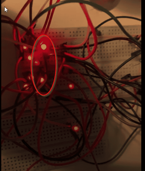

I have made a basic code to Charlieplex a bunch of LEDs. I have the problem that the last LED I am trying to turn on in the circuit appears much brighter than the others. Why?

My problem:
I built a standard Charlieplexing circuit to control 12 LEDs (see for example: http://www.multiwingspan.co.uk/arduino.php?page=charlie) on a breadboard.
To get LEDs lit up at the same time, I use a very small delay between when each pin is updated.
I get all the LEDs to appear lit up simultaneously, however, the LED that is supposed to blink (see the image above) somehow appears brighter than the other LEDs.
This is the code that I run on an Arduino UNO (the Charliplexing pins used are 13,12,11 and 10):

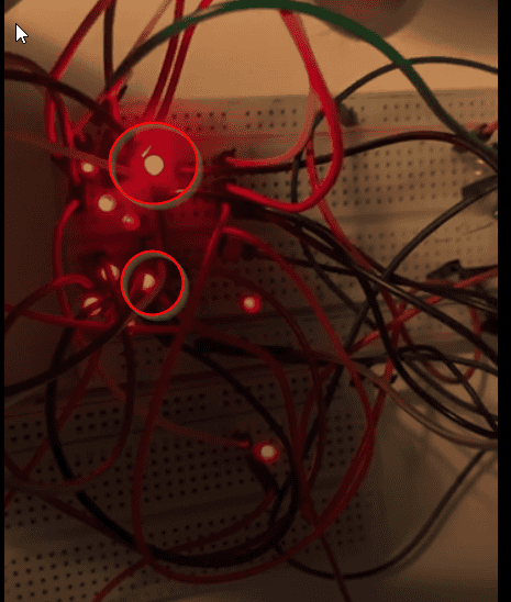

In the video below, I run the code above, which is expected to be turn on 8 of the 12 LEDs and the uneven brightness issue can be illustrated. Watch the video and you can see that these LEDs (LED 7 and 8) are always brighter than the rest:
(the breadboard connection won't win awards, I know...)
I did not connect the LEDs on my breadboard circuit in a logical order - hope you can bear with that. The 8th LED is supposed to alternate between on and off like in the image I provided above.
My setup gives me uneven brightness on just the last LED I want to illuminate. Why? Is it a timing problem with my code? Circuit issue? Charlieplexing limitation?
Many thanks for your help!
Some complementary information:
The LEDs are all identical. They are rated: Red at 20 mA: 1,92-2,06 V. I run them on an Arduino UNO with 150ohm resistors between each pin and the rest of the connections that the pin has.

No schematic? OK, then, I don't know. Partly because I don't want to take the time to read your code.
First step: separate HW vs. SW issues by swapping, with as little disturbance as possible, the I/O port HW connections. For example, what if one of your 150Ω resistors was really 100Ω? No amount of looking at your code will spot that.
You might do similar swapping in your code to distinguish between port HW or initialization differences and your high level code.

My first thought is that the first 11 LEDs may be switching On & Off at a rapid rate, thus appearing dimmer due to less than 100% duty cycle.
Then if the #12 LED is full on for a second, it will appear brighter than the rest of them.

Flashing lights look brighter than steady ones, hence their use on bicycles.

This is a software problem. Think about how much time there is between setPinState(allPinStates[0]); and setPinState(allPinStates[1]); and then think about the state of the pins during the delay(1);.
Also note that running a loop 1000 times with delay(1) in it does not give you a timer that updates once a second.

Simple inspection of the code reveals the timing problem faster than it takes for a scope to power up :-p
The last LED that is illuminated is on for 1 millisecond whereas the others are on for a few dozen CPU clock cycles.

With Charlieplexing you are always going to be stuck with the 1/12 duty cycle limiting brightness. If you use more pins to drive each LED individually (and you have 14 pins available on the Uno so enough for this application with 2 to spare) then you need to watch the maximum total current draw (or sink).
To avoid these issues (as well as free up the processor to do something other than spam IO pins without decreasing the duty cycle further) you could use a pair of 74HC595s, but my choice would be a PCA9685 and then you get individual PWM control of brightness too: as well as enabling cool dimming or pulsing effects this is useful for perceptual intensity matching if you are using different colour LEDs.

Many deep thanks to everyone who replied here! It was indeed a software issue in the end :) All looks good now after I made some improvements to the software. No brightness issues.
