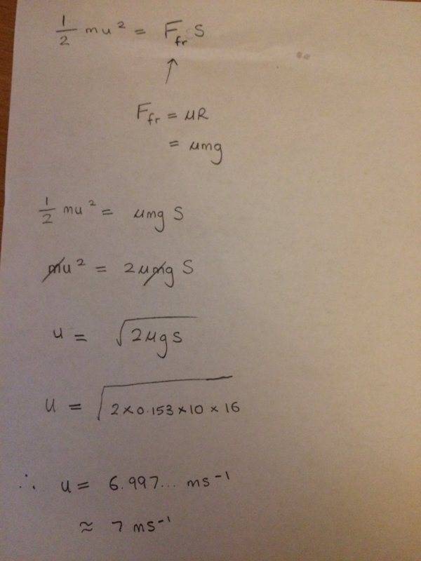

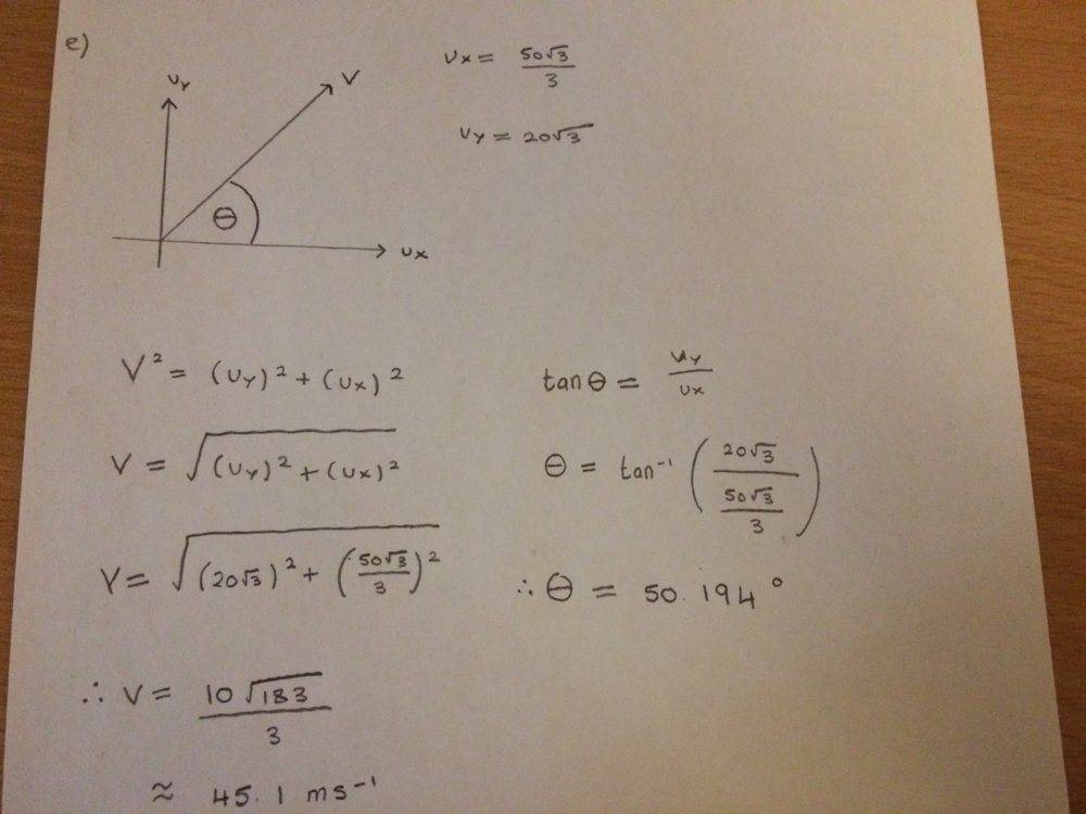

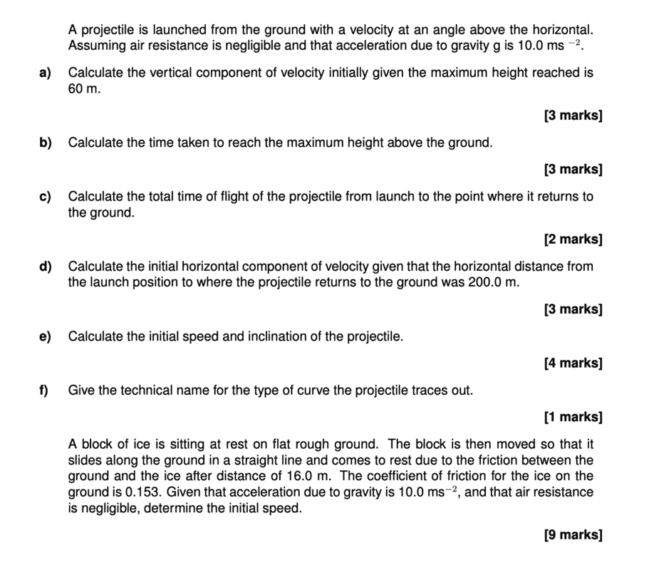

Have had a try at answering this question, and want to particularly know if I had done part e) correctly

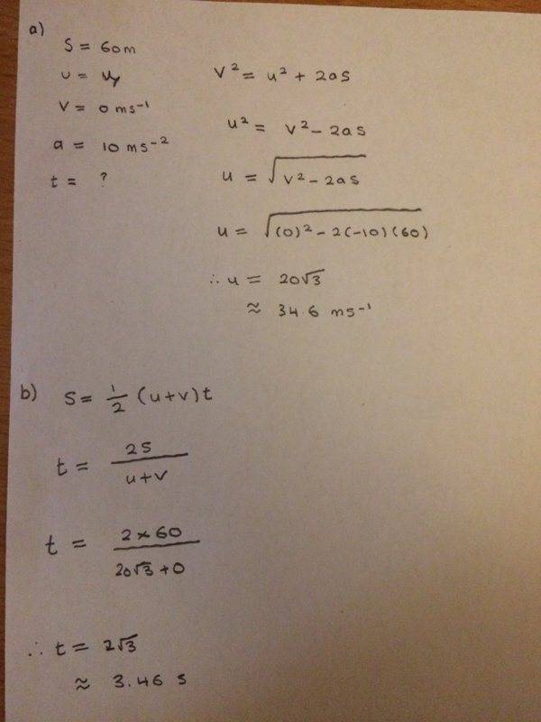

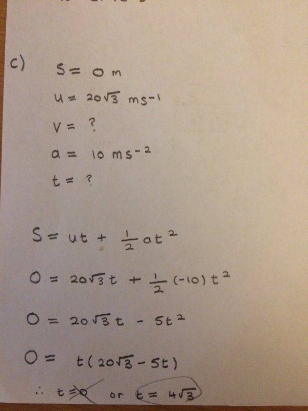

Here is my workings from the previous parts as I need to use some prior values that I have obtained before to do part e)

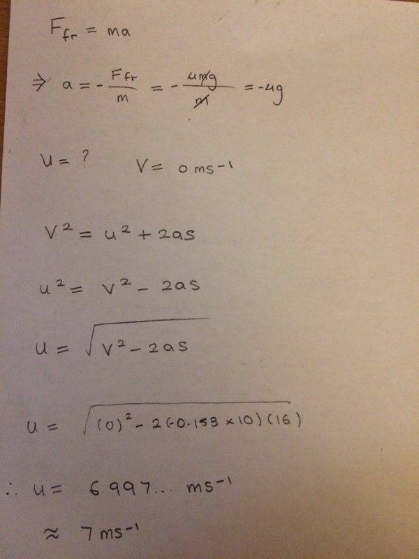

For the last part, there were 2 ways that I went about it. First one was using conservation of energy and the second was to use Newtons 2nd law and SUVAT. Both methods gave the same result so I guess that is alright.
Thanks!
Hi,
Under c) did you notice it is twice the answer for b) ?
I miss f) :wink:
The last part went fine too.
Your work is very neat and impeccable !

Yes I did know that the value of c) is double of b).
Since the trajectory of the projectile is symmetrical about the halfway point (maximum height) on either side.
So time taken to reach from ground to max height is the same as time taken to reach max height to ground. In fact it's just a simple model of a quadratic curve. I just wanted to clarify myself by using SUVAT here :oldbiggrin:
