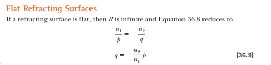

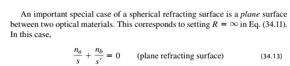

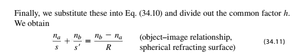

I am not sure, I just derived the equation from the textbook, but although the equation has derived from the case of a picture in the opposite direction of the body, but I think the equation is still valid to all the cases, whether the body and the picture are on the same side, or in two different sides. I have found it as written here in many textbooks (Halliday and Resnick, Sears and Zemasky, Serway and Jewitt... etc) I think it is a general equation which can be applies in both the previous cases. (If you think the problem in my solution is in this part, then I will be indented to you if you mention this).
Sears and Zemansky:
Serway and Jewitt:
Halliday and Resnick:
haruspex said:
Note that for the flat plate case R=∞, which gives q=−pn2n1.
This is exactly what I think, and which is written in my textbook (See the pictures above)
That the equation is given in all these sources is not the point. What you have not stated is what the distances represent in those texts.
Look at figure 2.4.3 in https://phys.libretexts.org/Bookshelves/University_Physics/University_Physics_(OpenStax)/University_Physics_III_-_Optics_and_Modern_Physics_(OpenStax)/02:_Geometric_Optics_and_Image_Formation/2.04:_Images_Formed_by_Refraction
The object and image are assumed to be on opposite sides of the surface, and the values are positive in that case. If the object is sufficiently close to the surface, on the concave side, and is in the denser medium (as is the case here) the image is on the same side as the object, so the equation produces a negative answer.
Since you are investigating whether q can be greater than p, on the same side, it would be less confusing to adopt the convention that they are positive on the same side, so flip the sign of q in the equation.
Having done that, combine the equation with q>p and see what results.
