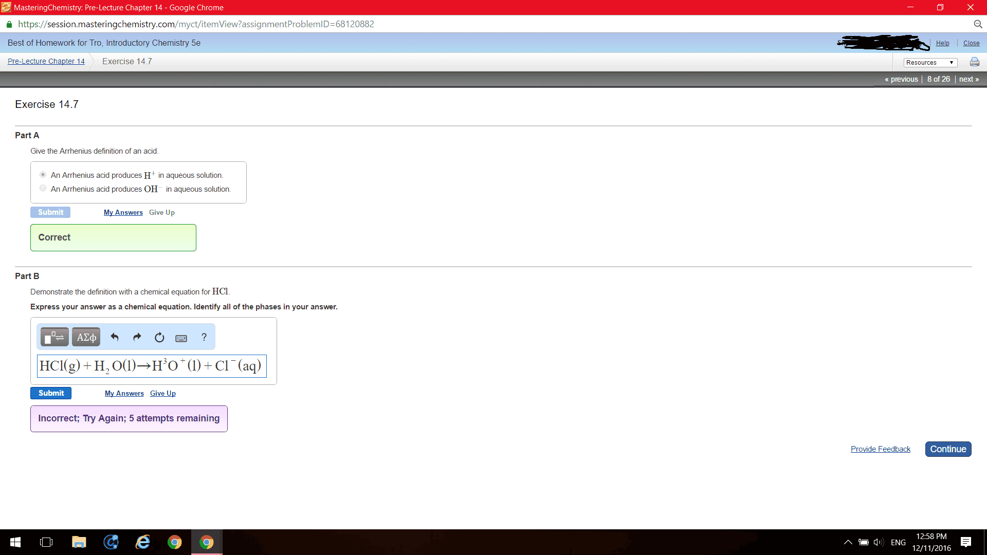

Demonstrate the definition with a chemical equation for HCl.
Express your answer as a chemical equation. Identify all of the phases in your answer.
My Answer:
HCl(g)+H2O(l)→H3O+(l)+Cl−(aq)What the answer said:
There is an error in your submission. Make sure you have formatted it properly.
My Answer:
That's a rather generic error. I have no idea what it means.
Are there any more details about the error?
And since I'm not familiar with this particular submission system, can you perhaps provide an example of what a similar accepted submission looks like?
Here is the image and how my answer look.
Shouldn't it be $H_3O^+$? (Wondering)
