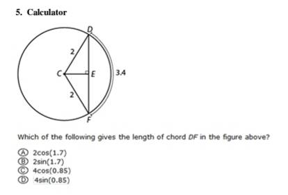

Ok this should be just an observation solution ..
But isn't the equation for chord length
$$2r\sin{\frac{\theta}{2}}=
\textit{chord length}$$
Don't see any of the options
Derived from that..
  • Circle with centre C and radius 2, chord DF vertical through point E, arc labelled 3.4, with multiple-choice options A to D giving expressions for the length of chord DF.
Hi karush.
All the information is there. You just need to calculate the angle $\theta$ from the arc length $s=r\theta$.
Olinguito said:
Hi karush.
It is asking for chord lenght!
I would start with the arc-length formula to find the subtended angle:
$$\theta=\frac{s}{r}=\frac{3.4}{2}=1.7$$
Then, use the law of cosines:
$$\overline{DF}=\sqrt{2^2+2^2-2(2)(2)\cos(1.7)}=2\sqrt{2-2\cos(1.7)}$$
Lastly, a double-angle identity for cosine:
$$\overline{DF}=2\sqrt{4\sin^2(0.85)}=4\sin(0.85)$$
Ok
So that's where .85 comes from
So then it's D
And to do that, you need to know the angle $\theta$, don’t you? Calculate that first!
Why of course we do!
However for this SAT question
It is only asking which
Expression to use
We should know that 1.7 is not the $\theta$ we need
and we have use sin $\theta$
So even without any calculations we should see that it is D
You were asking
That was because you were given arc length $s=3.4$ (and radius $r=2$) but not $\theta$. I was therefore instructing you to compute $\theta$ from the formula $s=r\theta$ so you could use it in the formula $2r\sin\dfrac{\theta}2$ for the chord length.
