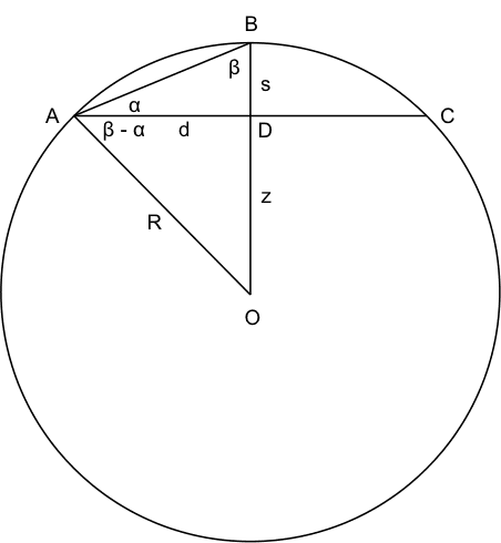

Study the attached drawing. Here ##AC =2d##. Also ##\beta = 90^o-\alpha## and ##\beta-\alpha =90^o-2\alpha##.
Now ##R=s+z=s+R\sin(\beta-\alpha)=s+R\cos(2a)=s+R(\cos^2\alpha-\sin^2\alpha)##.
In terms of the fixed distance between the outer sensors ##2d## and the measured distance ##s##, $$\cos^2\alpha-\sin^2\alpha=\frac{d^2}{d^2+s^2}-\frac{s^2}{d^2+s^2}.$$ Substitute and solve for ##R##. It's a simple expression.

@kuruman One problem this has is that unless you choose the radius to be ## R+r ##, the distance ## AC ## is not precisely known. The distance ## AC ## needs to be the distance between the centers of the two outside balls, rather than the point of contact to the radius ## R ##. ## \\ ## Edit: Your ##d ## is my ## x_1 ##, and your ## s ## is my ## d ## of post 2. With this correction to your calculation, I have verified that your answer is the same as mine: ##R+r=\frac{x_1^2+d^2}{2d} ##, using the notation of post 2. ## \\ ## Additional comment: I think for this one, trigonometry-based solutions are somewhat difficult. The algebra-based solution of post 2 appears to be much simpler.

Here is a simple, fully geometric approach, no trig. Refer to the drawing in post #4 where the radius of the circle is actually ##R+r##. From the intersecting chords theorem ##(AD)\times(DC)=s\times[2R-s]##. Solve for ##R## which is really ##R+r##.
