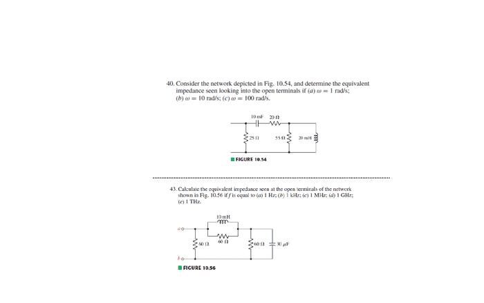

I'm trying to find the equivalent impedance of these circuits for each of the frequencies. However, I am re-analyzing and re-drawing the circuits for each of the frequencies, which is a lot of busy work. Is there an easier way of analyzing them?
Yes. Solve for the impedance with a symbol representing your frequency. Use this solution to solve each part.
