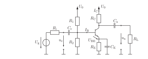

Hello!
I am having trouble with this emitter circuit.
I am given U0 as well as all of the resistor values and I need to calculate the following.
## I_c## ##U_{CE} ## ## U_{C} ## ## U_{a} ## ##U_{Ca}## ##U _{Re} ## Now important to note that all of these need to be calculated at the working point of the circuit.
So since I am doing a DC analysis,I simplified the circuit and this is what I end up with
Now the Ri2 and ## U_L ## I've calculated using Thevenin circuit theorem;
$$ R_{i2} = R1||R2 $$ and $$ U_L = Uo * \frac{R2}{R1+R2} $$ ; and so far this matches the solution in the book. They simplified the circuit as well and calculated the Thevenin voltage and resistance the same way. Now I need to calculate Ib; or the base current. I used Kirchoffs law and the fact that Ic=B*Ib and I end up with this
$$ I_b = \frac{U_L-0,7}{Ri2+(B+1)Re} $$ and when I plug in the given values I get the correct answer. Plugging this Ib in the formula for Ic (as I've written it above) I get the right Ic as well, so far so good.
Now I've tried calculating Uce so the Collector-Emittter voltage and I put a loop on the right hand side of the simplified circuit and I get that
$$ U_{CE} = -U_{c} -U_{RE} + Uo $$ and to find Uc I simply used Ohm's law since I have Rc and Ic and for Ure the same, I found that the current running through Re is simply Ic+Ib and used Ohm's law. This gets me the right result as well.
Now calculating Uc gives me trouble. I simply figured it was Ohm's law but I couldnt get the right voltage. After looking at the solutions they calculated Uc like this;
$$ U_c = Uo- RcIc $$ What I don't understand why are they subracting Uo from this ? Shouldnt the voltage simply be RcIc?
Also the way they calculated ##U_{CE} ## is quite odd they calculated it like this;
$$ U_{CE} = Uo - I_c * (Rc + (1 +\frac{1}{B})Re) $$ I get the same result but why would they calculate it like this?
Also this equation is the loop equation I basically have and here the term Uc is simply resistance times voltage. Why was was Uo subtracted from this.
Thanks !

UC = U0 - RCIC
They are NOT subtracting U0 from something, they are subtracting something from U0. That is, they start with U0 and subtract things that decrease the voltage.
What is the voltage drop across RC?
How does that compare with the equation they use?
Also the way they calculated UCE is quite odd they calculated it like this;
Again, they subtracting things from U0, leaving a result of UCE.
They combined all the voltage drops (current times resistance) into one equation and subtracted the result from U0. (See if you can name (in words) all the variables in that formula.) What is left is the C-E voltage across the transistor.
Hope this helps!

You are right my phrasing was bad they are subracting something from Uo,but my question still remains why? The voltage drop across Rc should be simply currents times resistance,why does that need to be subracted from Uo?
What is even more confusing is the second equation.What I mean is you are completely right they in how they get to the equation for Uce. I took a closer look to the equation and they did the exactly same thing I did; I did this $$ U_{CE} = - Uc - U_{RE} + Uo $$ I used kirchoff law since Uo is across the entire circuit I assumed the voltages all voltages are pointing down and the loop goes counterclockweise.
And they did exactly what you said they subracted everything from Uo to get Uce,with everything we mean every voltage that is influecing the Uce voltage.
$$ U_{CE} = Uo - I_c * (Rc + (1 +\frac{1}{B})Re) $$ This is nothing else als Uc and Ure that I have; (Uo is the same)
Because when I multiply the brackes I get this; -IcRc that should be the voltage across Uc and ##-Ic(1+\frac{1}{B})Re) ## and that is the voltage across Ure.
So if I am not mistaken in this equation Uc was simply current time resistance,why is it when we calculate it seperatly do we have to subtract that voltage drop from Uo.Also also; I've plug in the values of the voltages according to the textbook. According to them;
##U_{CE} = 5,32V ## ##U_{C} = 6,21V ## ##U_{RE} = 0,88V ## and Uo = 15V
Now for my Uc I get = 8,79V
Now assuming Kirchoffs Loop law need to be obeyed like in usual circuits it should be true that
$$ 0= Uc + U_{RE} +U_{CE} - Uo $$ If you plug in the given values this is not true,but if you plug in my value it is 14.99 -15; and to note is I have not paid that much attention to rounding the numbers.
Could it be possible that it is a fault in the script? These are by no means perfect and we have had some errors occur before.
Thanks!
Because they asked for the voltage at the Collector, they did NOT ask for the voltage drop across RC... but you Do need the drop across RC to find the Collector voltage. (Just like a 2-resistor voltage divider, if you know the supply voltage and the drop across the high-side resistor you can find the voltage at the top of the low-side resistor.)
See the paragraph above. Both parts of the problem calculate the Collector voltage, UC. The first calculation was finding the drop across RC and subtracting that drop form U0, giving UC.
The second calculation was finding the drop across RE and the transistor.[/color] Since the reference for this calculation was Ground (or circuit common), you calculated the Collector voltage directly.

I think you are confusing UC and the voltage drop across RC. UC is the supply voltage minus the drop across RC.

Oooooh okay that makes sence. I was calculating correctly but not what whas asked from me, I was not aware that Collector voltage and the drop at Rc are not the same. Thank you Tom!
But I have another question. I have calculated all that is asked from me and what we can see in this handwritten circuit (working point) but in the solutions they also calculated Ua and Uca. Ua is the output voltage and it is 0 and Uca=Uc. I do not understand where this comes from? Im aware that these come from the original circuit but why? In the solution for all of the voltages in the working point was the original circuit simplified just like I have it and there are no capacitors there and no output voltage. How do they find these voltages?
Hope it's OK to chip-in.
Refer to the original (complete) circuit. The operating point (DC conditions) is a steady-state, so there are no currents through the capacitors (even though the capacitors are charged).
As a result, there can be no current through ##R_L##. This means the voltage across ##R_L## is zero. This voltage is the same as the output voltage, i.e. ##U_a=0##.
The right side of capacitor-a has potential = 0 (because ##U_a = 0##). The left side of capacitor-a has the same potential as the collector (##U_C##)
Potential difference across capacitor = ##U_{Ca} = U_C - 0 = U_C##
Edit - typo' corrected.

Hi - may I ask you if you know the value of B=Ic/Ib ?
I am asking this because you have assumed that the BJT will work as a current amplifier. Therefore, you need the quantity B.
LvW said:
@arhzz,
B was given a value of 300
