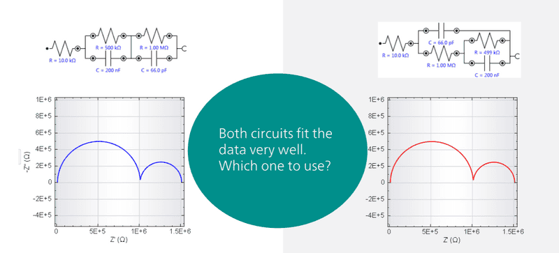

Hi all,
I'm fairly new to electrochemical impedance spectroscopy (EIS). On some slides I was given, I have been provided with two circuits which would produce the same nyquist plot. I was wondering what real-world scenario these circuits would relate to. I know that the left-most resistor in each represents the resistance of the solution, but am unsure about the rest of each circuit. Any suggestions would be greatly appreciated, or resources which I can look at to get a better understanding.

Welcome to PF.
Is this for schoolwork? What information sources do you have for this work?
This is my own research. I've read a few tutorials that only consider simple systems (e.g: Randles circuit), but am looking to see how more complex scenarios fit.
