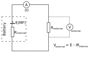

A battery has an emf E and internal resistance r. A variable resistor R is connected across the terminals of the battery. Find the values of R such that
(a) the potential difference across the terminals is a maximum;
(b) the current in the circuit is a maximum;
(c) the power delivered to the resistor is a maximum.
I=E/(R+r)
Im not sure if question (a) is talking about max voltage we can run on the circuit, or is just talking about the EMF in which case it never changes.
b) I assume when R=0 we get max current, no resistant means max current.
C) Max Power transfer theorem says when R=r we get max power.
Any help with a) greatly appreciated.
The question asks about the terminal voltage (the external connection points to the battery) in question (a).
Likes Fat_Squirrel
Cheers.
Ok, in that case its when the current through the circuit is zero, so basically when we have a switch or a resistor with infinite resistance?
That makes sense.
I assume I'm okay on the other two?
Fat_Squirrel said:
That makes sense.
Yes, for perfect circuits and batteries.
Likes Fat_Squirrel
Thanks heaps. Feeling stupid. Not good when I'm stuck on one of the first questions. Appreciate the quick response. Now I can enjoy my wine in peace.
Question (c) while valid is not the best way to transfer power 'from' a battery or DC power supply. In practical circuits the load resistance is usually higher than the source internal resistance to minimize internal resistance power loss (lost to heat) with a greater percentage of power going to the load.
