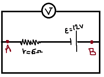

What number does the voltmeter show?
i=ε/r
Circuit schematic: a voltmeter V across the top branch, connected in parallel with a battery of emf E=12V and internal resistance r=6Ω in series on the lower branch.
It shows 0 and it's obvious why. I have another question.
Can I say that in this circuit the current is maximum and it equals to ##\frac ε r = 2A##?!
Circuit diagram: a voltmeter V connected across points A and B, with a resistor labelled r = 6 Ω and a cell labelled ε = 12 V in series between them, all in one loop.
Someone asked me this question:
Are A and B two ends of the wire? If yes, Why is there current in the wire even though the potential difference between its two ends is 0?
I think this ambiguity is created because the shape of the given circuit is different from the real circuit. In reality, the internal resistance is not visible and the two ends of the wire are connected to the positive and negative terminals, so the potential difference is not 0. Am I right?
It's a circuit diagram; there may not even be a wire in a realization of this circuit: if the terminals of the resistor are connected directly to the terminals of the battery, the circuit is still represented by the same diagram, and points A and B would be one and the same point !
The equation:$$E=IR$$makes no prediction for ##I## when both ##E## and ##R## are zero. The equation is consistent with any current.
The shape of the circuit presented in a schematic is irrelevant. However, human intuition is easily confused by the layout choices on a schematic.
But we've not confused you -- you've correctly calculated how much current will flow in this particular bare wire.
An easier example with no chance for confusion is a simple loop of wire. Any current at all could be flowing around the loop. This is physically possible.

OK, let's try an explanation that doesn't include things like magnetic fields and capacitance, which you didn't ask about....
Your result is the necessary conclusion of Kirchhoff's Voltage Law.
First of all, except for superconductors, there is always some resistance in any connection. In schematics it is understood that it is so small we don't have to show it; i.e. small compared to 6Ω, in your case. Let's say it's 1mΩ, then the current would be actually 12V/6.001Ω = 1.9997A. It is unusual for engineers to care about such a small difference, but if they did, they would need to show that 1mΩ in their schematic.
The superconducting case (0Ω) is a bit more odd but it still works. Suppose there was 2A flowing and for some reason it "decided" to decrease to 1.99A. Then the voltage across the short circuit would rise to 12V - 1.99A⋅6Ω = 0.06V. Then the resulting additional 0.06 volts across the connection will make the current increase back to the stable value of 2A. The same thing happens with a momentary increase in the current. There is an equilibrium value of current and any deviation from that will result in a voltage to restore the balance.
So, there is only one solution that creates the voltage balance that Kirchhoff described. For a superconductor it's 2A with 0V. For the 1mΩ "short circuit" that balance happens with 1.9997A and 1.9997mV.
Yes! Absolutely. I think something that people misunderstand is that schematic diagrams are a very stylized approximation of the salient features of the real world circuit. In real life, that 6Ω resistor also has capacitance and inductance and maybe some non-linearity that makes it not follow ohm's law precisely. But only if you look very closely and care about these subtle effects. The schematic is a way for the designer to say things like "the resistance of this connection isn't important", or "pretend that this resistor is perfect". Then if an engineer wonders about the real behavior of that resistor, they'll need to do a bit of research on the specific part used. You simply can't draw a perfect schematic, and there is a point when more information is detrimental to its purpose.
