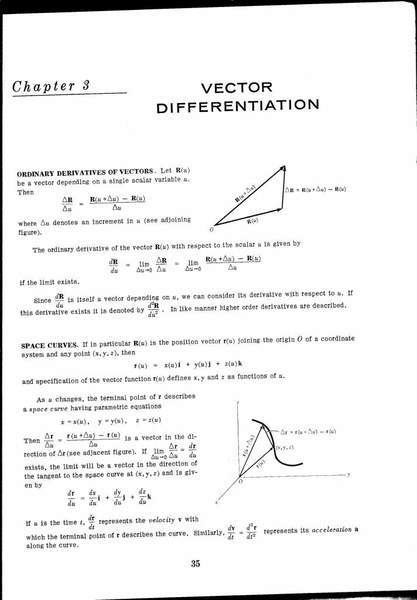

ehild said:
...Descartes components...
ehild
Never heard of it, any link would help. :smile:
