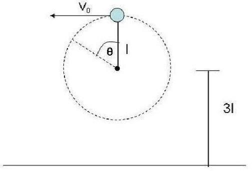

Everything is in the pictures.
I did part A, I have a problem with part B.
10x in advance.
  • Diagram of a ball on a string of length l swinging in a vertical circle about a pivot, with the ball at the top moving left at speed V0 and angle θ measured from the vertical; a vertical dimension of 3l is marked from the ground line up to the level of the pivot.
