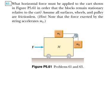

Hi
I have solved this problem but I have some doubts about the logic I have used at one point.
I have attached the problem in 1.jpg. Now I am trying to construct a free body diagram
for the mass M. First, there is force [tex]\inline{F}[/tex] in the right direction. And as usual, there is force of gravity [tex]\inline{Mg}[/tex] downward and the normal reaction
[tex]\inline{N}[/tex] upward. Also there would be a force exerted by the mass [tex]\inline{m_2}[/tex] towards the left, let's call it [tex]\inline{F_{21}}[/tex]. From top, there would be a force exerted by the mass [tex]\inline{m_1}[/tex] on [tex]\inline{M}[/tex].
Now let's say that there is a tension [tex]\inline{T}[/tex] in the string when the system is going to the right. Since pulley is frictionless, the tension in both sides would be same and since the pulley is attached to the mass [tex]\inline{M}[/tex] any force exerted on the pulley would be exerted on the mass [tex]\inline{M}[/tex]. Since force [tex]\inline{T}[/tex] is exerted
on the mass [tex]\inline{m_1}[/tex] ,by Newton's third law, the force [tex]\inline{T}[/tex] would be exerted by the m1 on the pulley, which means on the mass
[tex]\inline{M}[/tex] , towards left.. With similar reasoning, we can say that a downward force
[tex]\inline{T}[/tex] is exerted on the mass [tex]\inline{M}[/tex].
Do you think that was the valid reasoning. I got the right answer. The book's solution
manual does it differently but doing my way gives more insight into the forces
between the masses m1,m2 and [tex]\inline{M}[/tex].
thanks
Your reasoning sounds good to me.
Thank You, Doc..
