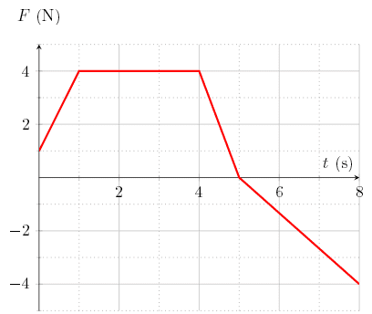

A particle of mass m=4.0 kg is moving along the x-axis. The particle is being acted upon by a variable single force F⃗ , directed along the x-axis. At t=0 s, the particle is moving at v_0=−3 m/s.
What is the first time t>0 when the particle comes to a stop momentarily?
because I know the initial velocity ,I know the initial momentum and I know the final momentum too(as the particle stops temporarily) but the force is variable otherwise I would have equated change in momentum to the impulse imparted.and found the time t.
what should I do?
What does area under a Force vs Time curve represent?
it represents impulse.
##mv_f-mv_i=J##
##0-m(-3)=∫F. dt##
##mv_f-mv_i=J##
##0-m(-3)=∫F. dt##
So you'll have to calculate the value of t at which the area of the curve becomes 12.

how will I do it? I don't have the force as a fn of time.
You do.

First you need to formulate F as a function of time between various intervals.

you mean from 0 to 1 sec its 2.5
from 1 to 4 its 12
but the answer is 3.375
REVIANNA said:
answer is 3.375
Indeed it is. That's the final answer.

No. From t=0 to t=1, what is F(t) and so on..

area under the f/t curve is all I know what else are you saying.also I am fairly new to calculus

Ok. So, from 0 to 4, the area is 14.5. So, t must be between 1 to 4. Agree? Because total area is 12 and out of that, 2.5 is already in between 0 to 1.

yes totally because of the areas.

So, from t=1 to t=4, you need to find at what value of t will the area be 9.5(i.e. 12-2.5). Can you do it?

You know its a rectangle from t=1 to t=4. You know the height. I believe the answer is in plain sight. Good luck..

##∫F.dt+F_c(t-1)=-mv_i##
(the integral is form t=0 to t=1) (c means const)
## 2.5+4(t-1)=-4*(-3)##
##t=3.375##
