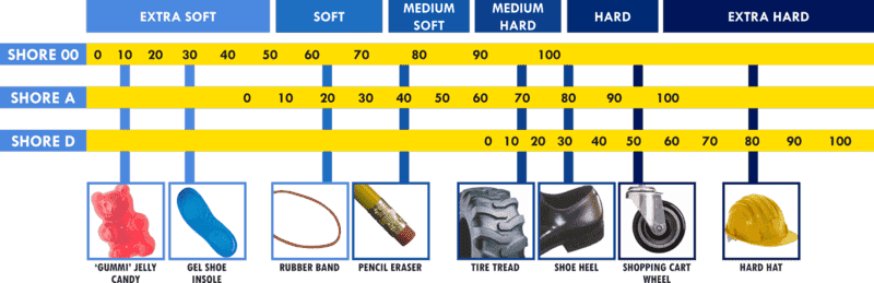

In racing , it all about tires, Tires, TIRES.Tires manufactured with tread pattern wet track cof = 0.4 dry = 0.7Tires manufactured with no tread for racing wet track = 0.1 dry track = 0.9Tires manufactured with tread but worn to wear bars ( no appreciable tread visible) = dangerNormal passenger car tires have tread that a large amount of non-contact open area so water and snow may squish out as the vehicle rolls over the road surface. By this very nature the tread tire will not have the best contact patch since most of it is open area. The racing slick has maximum contact area as no gaps exist. Conversely, this total contact means there is no way to displace rain water or snow so you have a maximum spin out condition = cof 0.1. We do race in the rain and have tread tires for this in various compounds. The tread depth is huge and a lot of area to displace the water.Both of these tires are available in many different compounds. The tire “hardness” is measured with a durometer. So the tackiness, grippiness, gumminess is a matter of choice (until the heat cycle comes into play) .
Low durometer reading tires (45) are very gummy, tacky and will wear out the quickest. We use these on race days where we have no sun light and cool track conditions. We use high durometer compounds (85) on hot sunny day with track temperatures over 110 degrees F. We record the cold Shore durometer reading , like 62 and it drops to 40 to 43 after the hot lap session. Again, both of these tires have significant tread depth. You can actually measure the depth of a slick as it is made with many depth holes present in the slicks surface. In both cases this tread depth acts like a spring and assists the tire surface compliance with the road surface.
In fact NASCAR has banned the use of tire dynometers that can measure the amount of springiness of tires as a cost cutting measure. The tread flexes as the vehicle changes direction in a turn. To not be able to do this we go into tire shear. Which is why the bald tire is the most dangerous. The tire was manufactured with tread that is no longer present. So we have no ability to flex. We also have a tire suffering many many heat cycles.A tire heats up when the vehicle is moving and cools to a steady state when it is stopped and parked. This is one heat cycle.
When the tire tread is completely worn off we have a whole lot of heat cycles and the tire compound has changed to harder durometer readings.Hope this helps a little
rm
