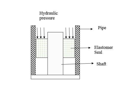

My situation is different. I have to measure friction co-efficient of elastomer rubber and steel contact. This rubber is used in the pipe for sealing purpose. Rubber dimensions are OD: 102.5mm; ID: 47 mm ; Thickness: 31.5 mm the pipe size is 4 inch dia. Need to measure the pressure and friction inside the pipe wall and rubber.
I think you may be trying to find the force needed for disassembly rather than the coefficient of friction.
Unless you know the force holding the steel against the elastomer there is no point knowing the coefficient of friction.
The contents of the pipe may be a lubricant. Many seals work by the application of unbalanced hydraulic forces to cause distortion of elastomeric components such as O-rings. The hydraulic pressure increases the contact force of the rubber onto the steel which then holds the parts together with a force proportional to the hydraulic pressure that is trying to push the components apart.
Can you please attach a drawing of the pipe and seal section to your next post. What pressure is expected.
I have to apply 30 KN force on the elastomer and then it will deformed. When the elastomer seal contact width the pipe wall then I need to measure the contact pressure and friction co-efficient of elastomer steel pipe seal.

In the diagram it looks like fluid can travel outside the elastomer and so also present pressure below the seal. Is that the case? You give seal OD as 102.5 mm. Pipe ID is 4” = 101.6 mm. There is 0.9 mm crush on the OD of the seal. That is a quite different situation to the diagram.
Consider a seal that fills the area between the shaft and pipe. The seal might rest on the base plate or have an independent reservoir of fluid between the seal and the base. Hydraulic force will apply pressure to the exposed annulus face of the elastomer. The elastomer will respond by maintaining it's volume while transmitting the face pressure to all other contact surfaces.
The force of 30kN is applied to the area of the seal face annulus.
Area = Pi * ( 50.82 – 23.52) = 6372. mm2
That represents a pressure of 30 kN against 6372. mm2
That pressure is transmitted to the outer contact of the elastomer with the steel.
Knowing the area of the friction contact is (Pi * 101.6mm * 31.5mm) = 10054. mm2
You can work out the contact force of the elastomer against the steel pipe ID.
Contact force, F = 30kN * 10054. / 6372. = 30 kN * 1.5778 = 47.335 kN.
Is this the “friction force” you require?
Without movement of the steel to elastomer contact we cannot know the coefficient of friction.
Is the hydraulic fluid a lubricant?
This assumed that the length of the elastomer was 31.5mm when installed in the pipe.

Actually, I have machined the pipe wall thickness and made a gap 3mm in between the elastomer seal and pipe wall. Then I have added compression load to 30 KN and then the seal deformed and contacted the pipe wall. I measure the contact pressure by some pressure strip but I got some lower pressure value. Now I want to calculate the co-efficient of friction of elastomer seal and inside the pipe wall. I am planning to add some hydraulic pressure on the elastomer to do the same experiment.
The simple rules to follow are:
1. The elastomer has a fixed volume, independent of pressure.
2. The pressure is the same throughout the elastomer and on all the surfaces.
If there is a gap between the seal and the inside surface of the pipe, then the force must be applied mechanically to the face of the seal. Hydraulic fluid must not pass the seal. The area of the annulus is that of the mechanical contact with the elastomer, not the diameter of the pipe.
You should calculate the initial volume of the elastomer. A 3mm gap will significantly reduce the axial length of the elastomer contact with the steel wall. 3mm on radius is 6mm on diameter.
