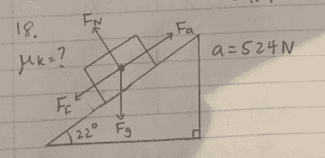

You are pushing a 53kg crate with an acceleration of 1m/s^2 up a ramp. The ramp makes an angle of 22° above the horizontal. If your applied force is 524N, what is the kinetic coefficient of friction between the crate and the ramp?
μ = Ff/Fn
Fn = m X g X cos θ
Fnet = Fa – mg sin θ +or- μmg cos θ
Fn = 53 X 9.81 X cos 22
Fnet = 524 – 53 X 9.81 sin 22 + μ X 53 X 9.81 cos 22

I am not sure how to incorporate the acceleration of 1m/s^2 into the equation.

That equation looks good, although you'll have to decide whether it should be ##+## or ##-##. And shouldn't that just be ##F##? What's the ##a## in ##Fa##?
What about Newton's second law? Isn't that relevant?

I think the equation should be Fa - mg sinθ + μmg cos θ
a in Fa is the acceleration
and Newtons 2nd law says that the external forces applied should equal ma which means that all the components of the equation should equal mass times acceleration?

I don't think I've ever seen ##Fa## in an equation. The dimensions are wrong, as what you have is an equation between forces. You can't have ##Fa## in there.
By having ##+\mu mg \cos \theta## you have friction acting up the slope. Does that look right?
Yes, that's a second equation: ##F_{net} = ma##.

shouldn't friction be acting towards the bottom of the slope because applied force is acting towards the top?
In this case, yes, friction is acting down the slope, because the applied force is large enough to accelerate the block up the slope. If the applied force were less, then the block might be trying to slide down the slope with friction opposing the motion.

This is my first time doing a question like this so I am not too sure but the equation ma = F - mg sinθ + μmg cos θ is correct? and if that's the case what is F?
##F## is the applied force. Note that I guess we should assume that it acts parallel to the ramp.
I'm still not convinced by the sign of that force of friction!

Yes the applied force is parallel to the ramp.
I should have shared this free body diagram earlier

Okay, apart from having ##Fa## rather than simply ##F## that looks good. Can you finish off this problem? You seem to be nearly there.

the answer and step I got are:
53(1) = 524 - (53)(9.81)sin22 + μ(53)(9.81)cos22
53 = 329 + 482μ
μ = -0.57
is this correct?

I've never heard of a negative coefficient of friction! Maybe you got the sign of the friction force wrong?

that's what i thought too maybe it should have been 524 + the rest instead of -?
I would vote for ##-##.

I see so if that isn't the problem what do you think I got wrong?
Plus = up the slope and minus = down the slope.
Your error is to have friction acting up the slope. E.g.

so the equation would be ma = F - mg sinθ - μmg cos θ

in that case the answer would be 0.57
