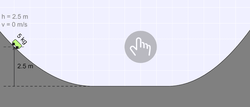

Hello, I am having trouble with this question: Imagine in real life there was a coefficient of kinetic friction of 0.4 between the plastic wheels of the cart and the wooden ramp. If there is only friction on the flat part of the track, how far would the cart go before it stopped if it started from a
height of 4m? The mass of the cart is 10 kg. Here is what I have done and I would appreciate it if someone could verify my work.
Velocity using the simulation at the bottom of ramp: 8.854 m/s
Step 2: Calculating the force of friction on the flat part of the track:
Fk = µkFn
Fn = (5 kg)(9.8 m/s^2)
Fn = 49 N
Fk = (0.4)(49 N)
Fk = 19.6 N
Step 3: Calculating distance before the cart stops.
The work done by friction:
Wfriction = Ffriction x distance
The work done by friction is also equal to the loss in kinetic energy:
Wfriction = Ek_initial – Ek_final
Wfriction = ½ mv^2 – 0 (because Ek_final = 0)
Equating expressions:
Ffriction x d = ½ mv^2
Rearranging for “d”
d = 10.0 m
Therefore, the car would go 10 m before it stops on the flat part of the track.
Are the wheels stuck?
Is the cart mass 5kg or 10kg?
Should the cart mass matter? The better style is to work purely algebraically, not plugging in numbers until the end. It has many advantages.
The wheels are attached to the cart and the mass is 5 kg. Sorry for the typo.
Yes, the wheels are attached to the cart. The issue is whether they are allowed to roll freely or not. There is also mention of the "flat part of the track." Is there a part that is not flat? What does the wooden ramp look like?
The ramp looks like this. (but the height isn't 2.5 m. It's 4m)

The cart rolls down the slope a vertical height of ##4m##. When it reaches the flat section the brakes are applied, the wheels lock and the coefficient of kinetic friction is 0.4. How far does the cart slide?
If that's the question, then ##10m## is correct.
Can you see why ##\mu_k d = h##? Where ##d## is the sliding distance and ##h## is the height?

Hmm… nothing there about the wheels becoming stuck. And nothing about axle friction or rolling resistance.
Taking the description literally, and assuming no rolling resistance, here is what would happen:
Since there is no friction on the slope, the wheels will slide without rotating there, so the cart will reach the horizontal at the speed you calculated.
On reaching the horizontal, the friction will cause the wheels to start to rotate, reducing the speed a little; but with no data on the wheels we cannot calculate that.
Thereafter, with no rolling resistance, the speed will remain constant until the cart climbs the far side. The wheels continue to rotate at the same speed although the cart now slows.
Having lost some KE to get the wheels rotating (which will include some lost to friction before rolling rate was achieved) the cart will not reach 4m before sliding back down.
Back on the flat, there will be more KE lost to friction while the direction of the wheel rotation gets reversed.
This process will continue, but without more detailed calculations I am unsure whether the total distance traversed is finite.
Clearly this is not what the problem setter had in mind. What was in that mind I cannot guess.

The answer of 10 m in the original post would be correct if a brake were applied to lock the wheels and prevent them from turning throughout the motion. Under this assumption, the wheels slide without friction while the cart is on the incline and with friction once they reach the flat part. The statement of the problem in post #9 mentions wheels but why bother if they are not allowed to roll?
