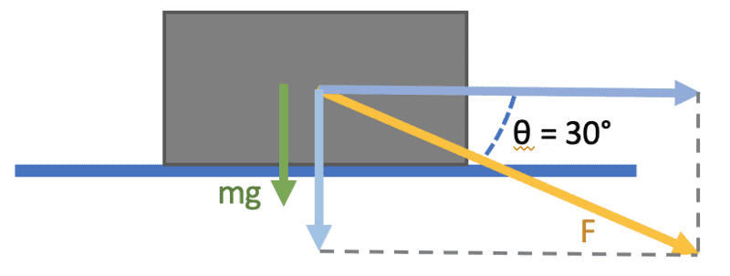

The wording of the problem might be confusing a bit. However, if you try a few combinations of calculation you will see the result should be smaller than your calculated one. This diagram presents the quiz probably better:
This is probably clear already.
