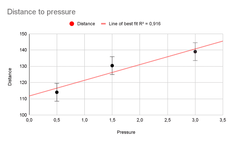

Can you present the correlation you've found between tire pressure and distance traveled?
Scatter plot titled Distance to pressure with three black data points with vertical error bars, a red line of best fit with R² = 0,916, x-axis Pressure from 0,0 to 3,5, y-axis Distance from 100 to 150, the line rising from about 112 to about 145.

You should probably collect a couple more data points (in between the three points), and maybe another just outside of the current domain if the tire permits. I would hesitate on proclaiming a linear correlation with 3 data points.
The resistance to rolling in this case is formed more of the tire’s carcase deformation than of the contact patch resistance to rolling (two surfaces in contact, like in traditional friction discussion).
More kinetic energy is consumed by cyclic deformation and heating of the ruber-fabric structure and air contained within the tire (assuming similar conditions for tests).
The lower the pressure, the higher air compression happens due to irregularities of the pavement (compression-decompression cycles, like inside a reciprocant air compressor).
I would estimate rolling resistance in function of tire‘s pressure, rather than pure rolling friction.

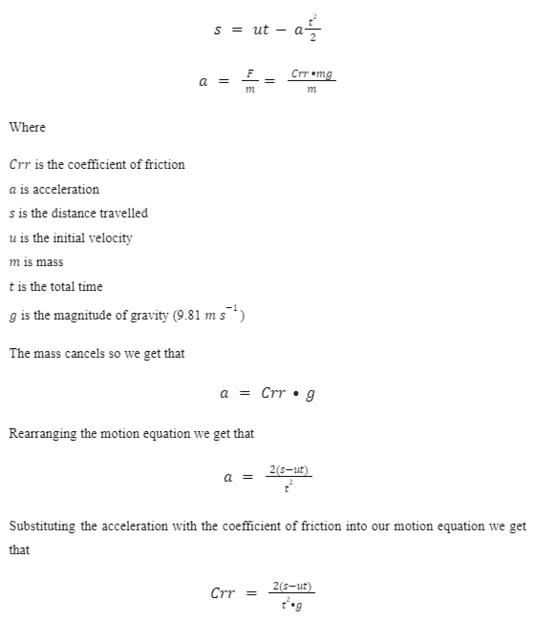

tymi9 said:
for any1 wondering I got the Crr like thisView attachment 321265
That is equivalent to:
$$f_{rr} = m \frac{v_o^2}{2x}$$
$$ \implies C_{rr}= \frac{v_o^2}{2gx}$$
I thought the objective was to obtain ##C_{rr}## as a function of tire pressure though?
Since you are ignoring the bearing force (assuming they are negligible), you can just use the equation in post#17 ( the extra unknown ##f_b## is not present anymore -at least in the model)
##C## would just be the intercept of your graph in post #6 ( Units of Length)
##\beta## would be the slope of the graph in post #6 ( units of length/pressure )
Then the initial condition would just be
$$ C_{rr}(0) = \frac{v_o^2}{2gC} $$
Finally it would all just reduce to:
$$ C_{rr}(P) = \frac{v_o^2}{2g} \left( \frac{1}{C+\beta P} \right)$$

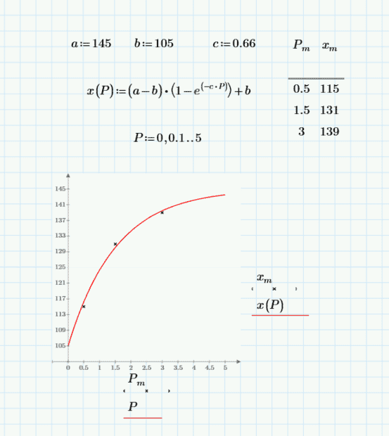

The effective diameter of the wheel is also changing. That can show up in your result, and may not be a 'friction' effect (depending on your precise procedure).
Also, you might consider looking for an exponential (decay) fit, as opposed to the linear model.
Worksheet showing a=5, b=2, c=0.3 and x(P) = (a-b)(1-e^(-cP)) + b with P from 0 to 10 in steps of 0.1, plus a plot of x(P) against P rising from 2 to about 4.9 and levelling off.
I'm not sure, but I would expect the effect of tire pressure on ##C_{rr}## to decay with increasing pressure. i.e. as the pressures get larger, the change in stop distance should get smaller.
The linear model might be fine for any reasonable tire pressure, but you should take some more measurements to verify it's the best fit for the tire...IMO.
I just eyeballed this, it looks like a decent fit for the three points you have.
Worksheet on grid paper: a := 145, b := 105, c := 0.66, model x(P) := (a - b)(1 - e^(-c P)) + b, with P := 0, 0.1..5, a table of P_m = 0.5, 1.5, 3 and x_m = 115, 131, 139, and a red curve plotted against them, rising from about 105 and levelling off near 145.
You need more data to verify, and whatever program you are using to plot will optimize the parameters for you.
Yeah, I figured that logarithmic function fits better. It gave me an R^2 of 0.998. Thanks for the help everyone
