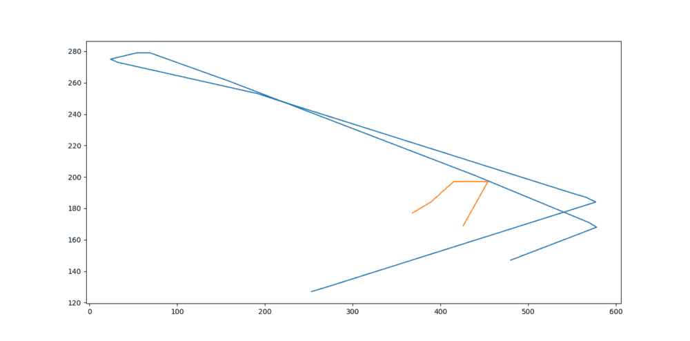

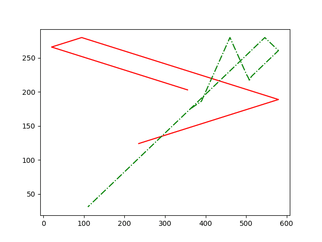

Technology news on Phys.org
The two pictures look wildly different. They don't have the same starting point checking either end of either track. In the original it looks like the orange ball starts at about 110,60 and the blueball at 400,100
Why not start the balls in the same place and then watch how their tracks differ from the original graph?
It could be as simple are not considering the balls radius when they collide ie using the collision point as the center of mass for one or both balls.
I remember that I put the same initial values but maybe in the drawing part there could have be some mistake.

Some general comments:
1) Even with correct logic, the results may be very sensitive to the exact point and angle of contact. Do you know that the ##\Delta t = 0.1## value is small enough for the accuracy needed? In fact, you may not be able to specify a fixed value for ##\Delta t ##. You might need to calculate intersection points and do the calculations at the exactly correct time of the impact. That would be an "event driven" simulation. Maybe you do that somewhere, but it is hard to tell.
2) Your code has a lack of comments as though you are charged $ for every comment. Some comments in the code with explanations of calculations is very good when you are requesting help.
3) As @jedishrfu pointed out, you should make sure that your examples and plots start in the exact same state.

This may be the type of simulation that is impossible to make it accurately duplicate a real example. Consider a collision of the two balls. Even the slightest change in the direction of travel can cause a significant change in the impact position and angle. No matter how small the initial error is, these errors accumulate and multiply with each impact until the simulation will have no similarity to the actual example.
If there is no impact of the two balls, the simulation has a much better chance of reasonably duplicating the real example.
One other observation is that the wall bounces show rounded trajectories which indicates some elasticity in the balls which makes it even harder to simulate accurately.
There is at least one obvious error in the simulation graph. There is an impact between the balls where the brown ball completely changes its direction but the blue one continues straight. That is wrong. That part of the code should be examined.

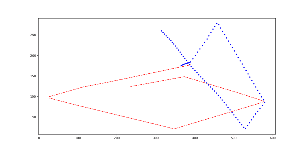

I discovered one of my errors and I fixed it..My new code looks like this.

Arman777 said:
Well that's kind of happens in my code at small changes becomes big but I guess its due to algorithm implamentation or some of the rounding errors that happens during the calculation.
Well if I decrease ##dt## the things get worse and my code does not work properly. (You can also try that). I am not sure how can I find the exact time of collusion.
Which part is hard to understand ? So I can explain in a better way that part of the code
I re-checked and I started them from the same point but I get same graphs. I don't know why that happens ?
In which part, real one or my version ? they shouldn't actually have rounded trajectories after bouncing. I solved the similar problem without collision and I got it right. I can share that code if its needed
Both versions show it, but now I'm thinking it may be due to your time step being too coarse.
In an ideal world, your ball trajectory should make a sharp angle each time there's a collision but the images show that a small deviation before going in a straight line. I guess this is because the collision occurred between two time steps.
Step 1: Correct the plots. I don't think that your plots look valid. Even the actual data plot has one ball changing direction for no apparent reason. You should get those corrected first so that you can see events that look like the simulation is wrong.
Step 2: Dump data. When you have a simulation where something might go wrong on frame 10 or 100 or 10,000, I like to dump as much data as possible to a file. Stuff your program with prints to a file. Then you can look at the plots to see strange behavior, go into the data file, find the lines that match the time of the bad behavior and examine the calculation results step-by-step.
I just copy and paste the data and draw it. If there's something wrong I don't think that's my fault.
I am trying something new. I understand which part is wrong and I ll try to fix it
I guess so. And I think this part of my code is what is wrong..

This is the lonely life of the programmer ultimately you own the problem and you own the code and only you can fix it.
My approach would now be to annotate with print statements or using a stepping debugger to walk through step by step and let the computer do the hard work and you review it and decide where it went wrong. Sometimes this takes an inordinate amount of time and sometimes you get an epiphany and see the gotcha in your code.
I might try online debugger but numpy array will not work in there. I guess i ll just give up and try to solve later on. I can print the values but somehow the things seems okay
One thing to change is from the function atan to atan2. Only atan2 keeps track of the quadrant correctly.
With the changes, do you have new data or a new plot? Your data and plot should include the exact initial values so that we know the initial conditions. A complete state would be the (x,y) positions, and (x,y) velocities. You should print all that at the very least. Looking at the latest plot in post #11, I don't understand the initial(?) slow velocity of one ball that then suddenly speeds up.
I ll try that.
That picture was bad i agree. Well one of the objects has larger speed than the other. I ll post the graphs and data tomorrow (its late here). The inital conditions are the same as in the post #1.

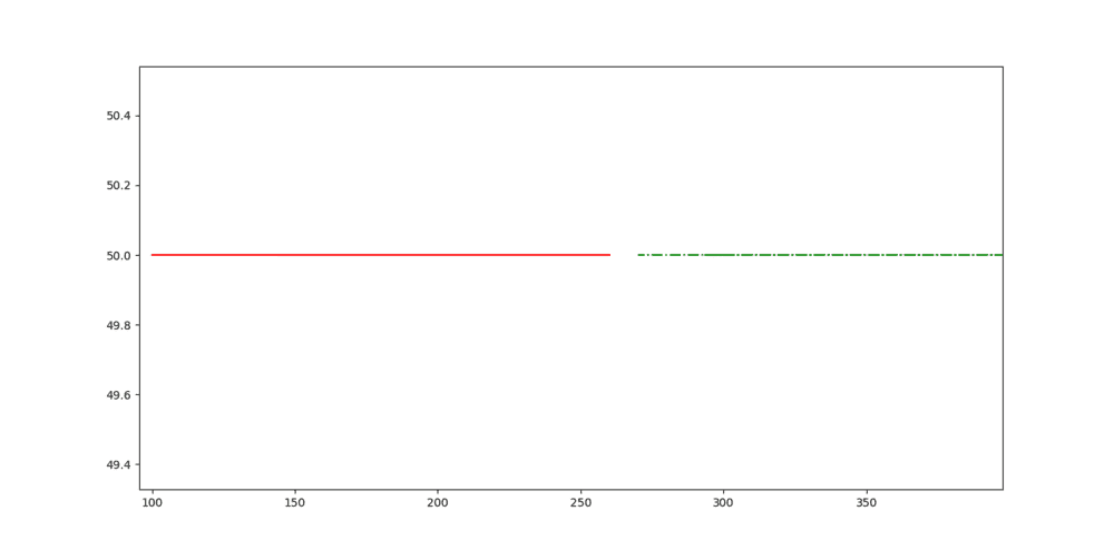

I tested a simple case where the data was "100 50 300 50 100 0 0 0 "
So Pa = [100, 50], Pb = [300, 50], Va = [100 0], Vb = [0, 0]
This means that when the ball "a" hits the ball "b", the ball "a" will stop and "b" will start to move with the same speed.
Here is the graph of it which I made by running my code.
as you can see the ball "a" stops ( the red line) after hitting the ball "b" ( the green dashed line)
Now our actual data was
235 124 365 176 181 34 -34 -14
I am getting kind of different images for different dt values. However, it also seems there are patterns in it.
In general, the answer is accepted when each value is within a range of the ±50 from the answer. The answer is 399 104 106 62
I am getting something like
355.7245911085971 202.9357121674485 109.5838027447148 30.913552143226795
or
399.8285196503435 194.65099630877506 173.18316603478155 98.13456362376074
or
355.2222801476294 203.03006892254314 86.53567162928971 74.22940763646008
So only Pa[1] value is off the range for an accepted answer.
I noticed an interesting thing. When I don't use atan2 (and use atan()) Pa[0], Pb[0] and Pb[1] are near the correct value but Pa[1} is not within the range of the accepted value. For instance
However, when I use atan2(), Pa[1] becomes an acceptable value but this time Pa[0], Pb[0] and Pb[1] are not within the range of the accepted value (sometimes they are but sometimes not)
For instance,
120.63023480435133 102.51617670357922 126.89167814780772 87.78085456018776
423.0257577924453 131.3197556076701 433.00009977473553 122.80783144468634
88.07944536334713 70.8248555671061 204.2954606777806 127.95018019597957
350.04117035554316 117.60994360228256 351.7414000498847 119.25903023712435
(all data values represent Pa[0], Pa[1], Pb[0], Pb[1] repectively)

The green line makes some unexplained changes of direction. It would be nice to know exactly what was going on when that happened. That is why I keep trying to encourage you to dump as much data as possible into a file. Then you could go to that part of the data file and see why the direction changed.
