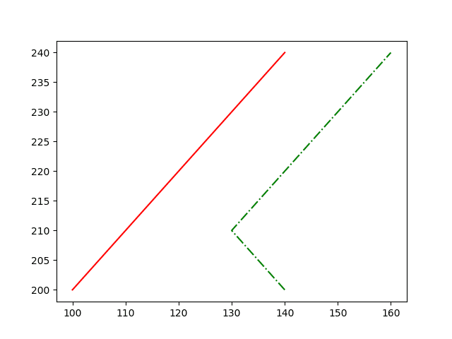

[CODE lang="python" title="Colliding_Ball"]from math import sqrt, atan2, sin, cos, pi, inf
from numpy import array

Now when you run this you ll get a data of points for each coordinate (Pa, Pb).
The image is like this
Its clear that ball b reflects but ball a does not. Thats really strange... I mean ball b acts like normal but not the a..
Who can spot the error :angel::angel:, cause I cannot.
P is the position vector so Pa and Pb are the position vectors of the ball a and ball b respectively. V is the velocity.
  • #37
I wrote angla_a instead of angle_a ... that was the reason.. So simple ..
FactChecker said:
It's my experience that it is possible to stare at code for a long, long time without spotting a simple error
The case has been proved :)
