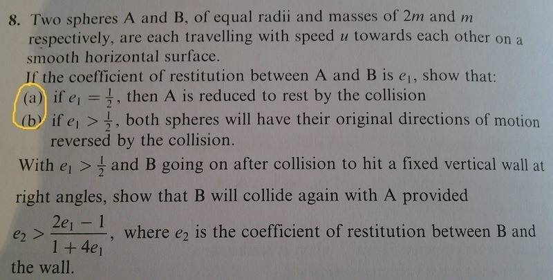

Question: First image

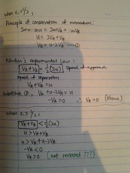

My working: Second image
I used Va+Vb for the speed of separation. I got the answer for (a), but couldn't get the answer for (b).
I know the proper expression is "Vb-Va" with Vb being negative.
But if I use Vb-Va, (a) would be wrong.
How come?
Principle of conservation of momentum, Newton's Experimental Law.
As shown in the second image.

Realize that when you post an image of your work, instead of typing it in, that it's difficult to make comments. (You'll get quicker help if you make it easy to comment. :wink:)
In any case, the speed of approach of the particles is (2u) - (-u) = 3u, not 2u. (Wrong!)
And the correct expression is Vb - Va, not Vb + Va.
Edit: My statement about speed of approach was incorrect; it should be (u) - (-u) = 2u, just as you had it. I misread the attachment.

Coconut (:-p) just lucked out. Coconut did not use the correct equation for velocity of separation and still got the correct answer. Coconut should redo the first part.
Coconut may assign right as positive and left as negative.
Its all the game of two equations: conservation of linear momentum and that velocity of separation one.

In any case, the best way to approach this is algebraically without plugging in numbers for e until a later step.
And the relative velocity is Va - Vb, so the key relation would be Vb' - Va' = e(Va - Vb).

coconut62 said:
u = 2Va + Vb (from principle of conservation of momentum)
Good. Call this equation 1.
Vb-Va = e (Ua-Ub)
Vb-Va = e (u- -u)
Vb-Va = e (2u)
Call this equation 2.
Now use equation 1 to eliminate Vb from equation 2, thus expressing Va in terms of u and e only.
Then you'll be able to draw some conclusions about Va.
(Then do the same for Vb.)
u = 2Va + Vb--1
Vb-Va = e(2u)--2
Solution:
u-2Va-Va = e(2u)
u-3Va= 2eu
Va= (u-2eu)/3
=u(1-2e)/3 (is this sufficient to jump to the next statement?)
when e> 1/2, Va<0

Good. The sign of 1-2e changes when e > 1/2.
