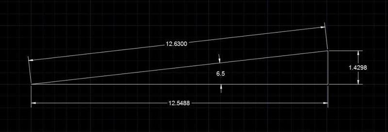

You can do it two ways I think... The car had an X and Y component of travel from where it started to where it ended up
I could have calculated the total energy over the 12.63m and using the triangle/ratio determined how much momentum it had... I think your method perhaps is simpler (but I didn't think of it) and would come out to the same answer
Here's a diagram of solving the triangle.. I cheated and used autocad but the pythagorean theorem and sin/cosine will do it for you too

Sure, but what do you get now for the red car's velocity just after collision in the direction perpendicular to the yellow car's?
You're right, and I'm not seeing how the two methods differ, I'd completely accept that the error is in my method... I'd just like to know where
