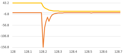

When the tank contacts the water, there will be a deceleration force. That force peaks at the point where the tank is penetrated to its maximum cross sectional area (about half way). The drag equation (search the term) should give a good estimate of the deceleration force from the water. That force, divided by the mass, will give you a deceleration. After that point, you need a numerical solution because the force changes as the velocity decreases.
The tank enters the water in a vertical orientation. It will probably change to a horizontal orientation after the water rips the parachute off. The change in orientation will cause the drag area and drag coefficient to change.
All of this can be done using a spreadsheet.

Yes, I have already realized these calculations through an Excel sheet. Though I have failed to mention that the parachute actually presents a huge factor to slowing down the tank to a speed of 43m/s.
Here the Graph of the collision is shown. The x-axis shows the time, while the y-axis is just fo reference. The yellow line is the velocity of the tank and orange the acceleration. Feel free to leave some feedback!
But my previous question was different. I want now to determine the deceleration of the tank colliding on a hard, inplastic ground. How can I tacle this without knowing the impact time, or at least estimate it. Thx!
For some ideas about falling objects, search earth penetrating weapon GBU-37. Look closely at the velocity, mass, frontal area, and penetration depth for both Earth and concrete for different bombs. Then make the simplifying assumption that penetration depth is proportional to sectional density (total mass divided by frontal area). Further assume that the deceleration is constant until it comes to a stop.
Now you have all information needed to estimate the deceleration, and thus the force. If the tank is strong enough to withstand that force, you are done. If not, the tank collapses into a wad of crushed metal.
This approach is crude, not very accurate, but can be done easily and should be good enough for your purposes.
