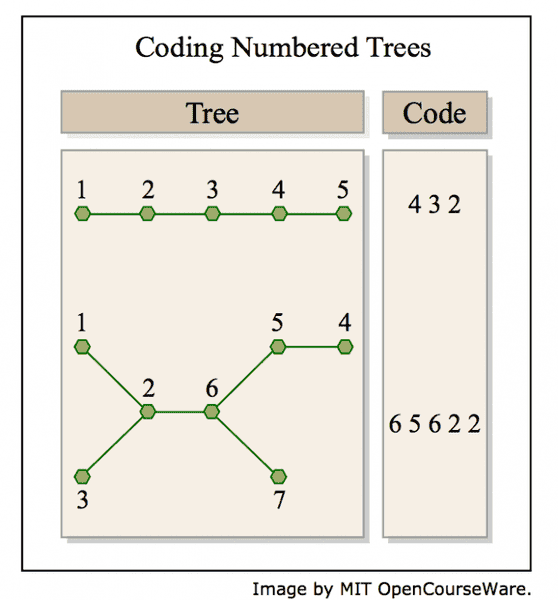

This problem is from MIT OpenCourseWare- a diagram is attached to clarify certain definitions. I'd like to check my answers.
The degree sequence of a simple graph is the weakly decreasing sequence of degrees of its vertices. For example, the degree sequence for the 5-vertex numbered tree pictured in the Figure 1 is (2, 2, 2, 1, 1) and for the 7-vertex tree it is (3, 3, 2, 1, 1, 1, 1). We’re interested in counting how many numbered trees there are with a given degree sequence. We’ll do this using the bijection defined in Problem 16.5 between n-vertex numbered trees and length n − 2 code words whose characters are integers between 1 and n. The occurrence number for a character in a word is the number of times that the character occurs in the word. For example, in the word 65622, the occurrence number for 6 is two, and the occurrence number for 5 is one. The occurrence sequence of a word is the weakly decreasing sequence of occurrence numbers of characters in the word. The occurrence sequence for this word is (2, 2, 1) because it has two occurrences of each of the characters 6 and 2, and one occurrence of 5.
(a) There is simple relationship between the degree sequence of an n-vertex numbered tree and the occurrence sequence of its code. Describe this relationship and explain why it holds. Conclude that counting n-vertex numbered trees with a given degree sequence is the same as counting the number of length n − 2 code words with a given occurrence sequence. Hint: How many times does a vertex of degree, d, occur in the code?
Diagram titled Coding Numbered Trees showing two numbered trees beside their codes: a 5-vertex path with code 4 3 2, and a 7-vertex tree with code 6 5 6 2 2.

a) The degree sequence tells you the number of degrees each vertex has. In the code, a vertex will be represented by a value that is one less than its degree. So, to go from the degree sequence to occurrence sequence, subtract 1 from each of its elements. If any values are 0 after the subtraction, they are omitted.
b) This is a permutation, I believe. There are 7! total possibilities, but to account for the possible redundancies from the 3 a's and 2 b's, divide total possibilities by 3! and 2! respectively.
##\frac{7!}{3!2!}##

Your answer to b looks correct. For c I would have thought the answer was 9x8x7x6/2=1512, since we are making four draws without replacement from the set {1,...,9} and the order for the last two draws does not matter. The ##k##th draw is a choice of the integer (code character) that has occurrence number ##a_k## where ##a_1=3,a_2=2,a_3=a_4=1##.
I get the same as you for d.
Ok, so my answer for c differs from yours by the 4! in the denominator. I think this was an inappropriate case to try to account for permutations of the brackets.
