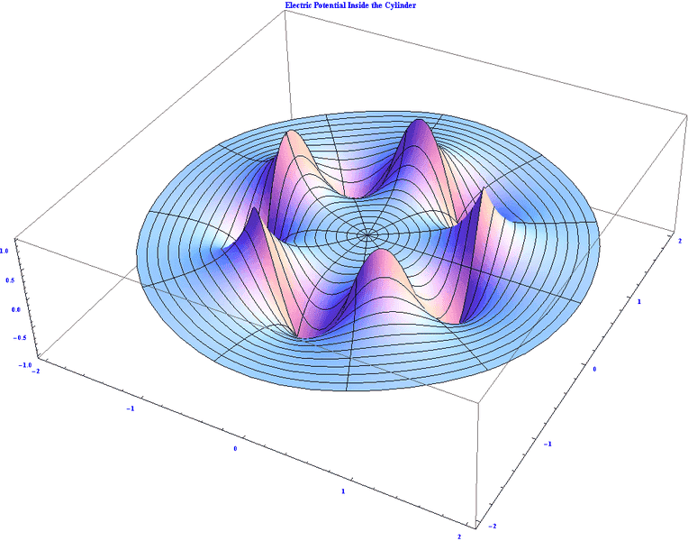

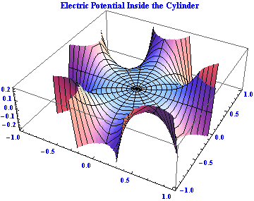

Hi,
I've been plotting potentials and electric fields inside and outside shells; when I create 2 separate RevolutionPlot3D plots for the potentials (1) inside the shell and (2) outside the shell, I'd like to combine them into one plot. I tried using the Show function, but Mathematica doesn't appear to like that route. Any ideas about how to combine the plots?
I've attached the 2 separate Mathematica plots as they exist at the moment.
On a separate note, is there a way to plot using RevolutionPlot3D with a piecewise function? This would bypass the above problem and skip straight to the solution.
Thanks...
Thanks...
I figured out that the range of Show defaults to that of the first plot, which would leave out most of the second plot in my case. So I used the option PlotRange->All and that fixed everything up...
pic of corrected curve is attached.
This has been a great monologue! Thanks for listening.
Chris
