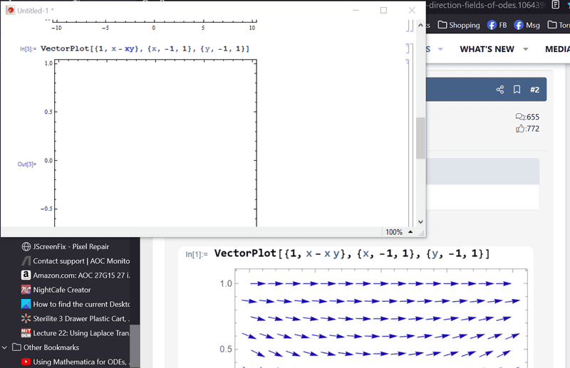

Ok, so tying into my last reply, this is why I *thought* I had it down, but something is wrong here...
I attached a screenshot below of your VectorPlot. As you can see above and to the left of yours, I typed in the same exact VectorPlot literally verbatim, and yet I got a blank graph with nothing on it. This is what I'm not getting, and the type of thing I keep running into. I *think* I understand something and know how to work it, then next thing you know, I type something in like this, and get a blank graph. This has happened for multiple things lately, which has led me to believe there is something I'm missing here.
But, I really don't have the slightest clue why yours worked, meanwhile I typed the same exact thing, and mine didn't give me a vector plot???

Ascendant0 said:
But, I really don't have the slightest clue why yours worked, meanwhile I typed the same exact thing, and mine didn't give me a vector plot???View attachment 351014
Note your input line In[3]. The variables that VectorPlot uses to plot are shown in green ("x" & "y"). Notice that "xy" is in blue, which means it's an undefined variable. You have to write "x y" with a "space" in-between to signify multiplication of x times y. This is very elementary in Mathematica, which makes me ask how much experience you have using that software?
Thank you for that. I never would've figured that out on my own. I compared them multiple times, but missed that.
