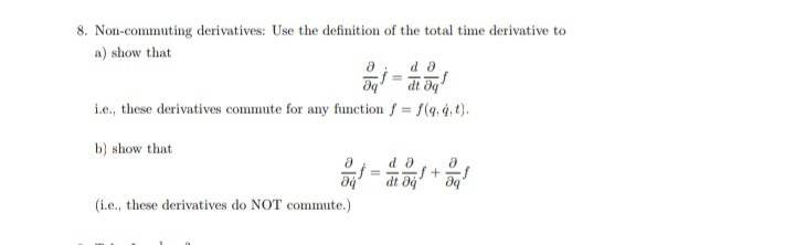

I don't understand what you asked about the definition of ##\frac{d}{dt}## but here is the question:
Problem 8 text with two parts: a) partial f over partial q equals d/dt of partial f over partial q-dot, stated to hold for any f(q, q-dot, t); b) partial f over partial q-dot equals d/dt of partial f over partial q plus partial f over partial q-dot, noted as not commuting.

If you don't know what ##\frac{d}{dt}## means, how can you prove anything about it?

##\frac{d}{dt}## means differentiating with respect to time. I have used this definition to get the results I got.

But, ##f## is a function of three variables. You can take the partial derivative of ##f## with respect to ##t##, but there is no way to take any other derivative with respect to ##t##.
In this case ##\frac{d}{dt}## looks like the regular single-variable derivative, but it can't be. It's called the "total" derivative in this context. It uses the same notation as the single-variable derivative, but it isn't a single-variable derivative in this context. So, you need to tell me how it's defined.
