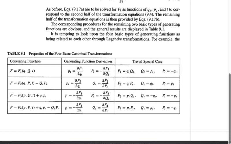

What's the physical meaning of adding the derivative of a function to the Lagrangian and to the Hamiltonian?
It has to do with “canonical transformations” of phase space coordinates.
The idea is you can derive new equations of motion using new variables. But they are ultimately the same.

Correct. Quite interestingly, while the issue seems clear to me, there is some confusion in the literature about it. I think the correct approach is given here
https://arxiv.org/pdf/1409.0692.pdf
