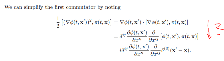

TL;DR
I don't understand what is happening from line 1 to 2.
It looks like he is taking out the derivative operator from the commutator.
Which I presume is not allowed?
Or he could be using product rule on commutator and then neglecting the 2nd part (maybe because it is trivially 0? I don't see why it is 0 tho: it is [nabla, Pi]Phi )
I think you can take the gradient outside because ##\pi(t,\vec{x})## doesn't depend on ##\vec{x}'##
And the Nabla acts on x' right?
Then it makes sense.
Yes, normally one makes the distinction and calls it ##\nabla'## or ##\nabla_{\vec{x}'}##, but in this case, you simply must deduce it from the context. Look that they change
$$\nabla_i = \frac{\partial}{\partial x' ^i}$$
