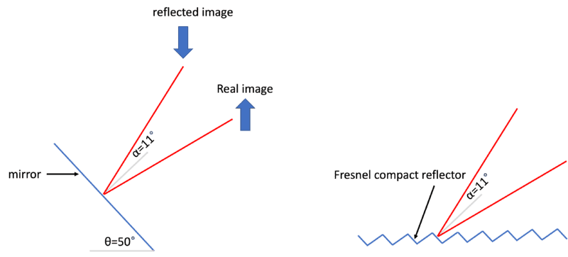

I have an imaging application, where a mirror with dimensions of 120x80mm at an angle of approximately 50 degrees to the mounting surface reflects a real image at approximately 11 degrees angle of incidence. Due to space limitations I need to reduce the height of the mirror. I was thinking of using a fresnel compact reflector as illustrated below :

A fresnel element is an approximation to a simple reflector or refractor. There will be some diffraction at the fresnel steps. That (along with the masking effect of the ‘reverse slopes’ is why it’s not high quality.
But a diffraction grating works because of diffraction / interference and the grating is plane. There are thousands of lines in a diffraction grating whereas the active sections of the fresnel will each have just one (imperfect) ‘line’. The directions of diffraction maxima will not be the same as reflections because of the dispersion (which is the purpose of a DG.)
So the two don’t have a lot in common. Imo. But it would depend on the spectral width of your source.

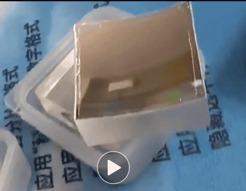

I found this video on this company's website showing ruled reflective gratings (possible concave)
https://www.alibaba.com/product-det...offerlist.normal_offer.d_title.60396337At1OmU
While one can observe the refraction during most of the video, at second 7 it appears there is specular reflection of the ceiling. The reflected image doesn't look that bad either. I include a snapshot I took:
I agree that they two optical elements don't have a lot in common as one relies on the principle of refraction and the other on the principle of reflection. But I am trying to figure out if a compact fresnel reflector can be manufactured with the same technique as a diffraction grating, but instead of making thousand of lines per mm, increase the groove spacing to minimize/eliminate refraction and allow specular reflection, for example hundreds or tens of lines per mm? For instance, would a ruled/echelle grating designed for the infrared wavelength work as a compact fresnel reflector for the visible spectrum? If yes, how do I go about calculating the minimum groove spacing for a given reflection angle (i.e. 50 degrees) for the visible spectrum?
Diffraction!! It's important to get this right.
That alibaba thing works by diffraction. The fact that it disperses the light it reflects tells you that. Afaics, it's a 'fun' thing.

A plane reflector produces a virtual image (let's get that right too). The angle of the reflecting faces is specifically chosen so that the reverse surfaces do not get in the way.

Fair enough but you need to get some basics, rather than relying on the old question and answer technique to get a solution to your problem. So far you haven't actually asked an answerable question. Those red arrows, labelled "reflected image" and " real image" mean nothing. An image is where the light ends up or appears to come from.
