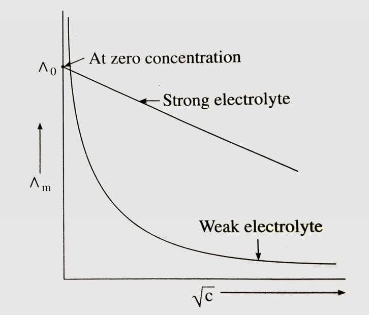

The molar conductivity (and consequently the conductivity & conductance) of a dilute weak electrolyte are much higher than those of strong electrolyte at any concentration. Also ##\ce{BaSO_4}## will show greater increase in dissociation with rise in temperature and thus the statement cannot be true for all temperatures(then again maybe saturated implies no ppt. to dissociate on heating).
