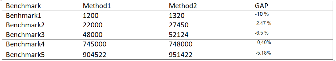

However I have an optimization problem (minimization problem), and the table (attached fill) represents a comparative study between the results of two methods, the first one performed better than the second one and to quantify the effectiveness of the first method we computed the gap which equal to:
GAP=((Method2-method1)/method1)*100
To compute the average gaps I used the arithmetic mean which equal to:
Mean-gaps=-(10+2.47+6.5+0.40+5.18)/5=-4.91%
And in conclusion I sad that method1 improved method 2 by 4.91 on average.
I used the average mean since the gaps results with no significant outliers, and the gaps are independents and not normalized ( normal)!
My question in is In this case which one I should use whether the arithmetic or the geometric mean to compute the average gaps!

Check your calculator or program:
Benchmark2 GAP should be -24.77%; you show -2.47%
Benchmark3 GAP should be -8.58%; you show -6.50%
I disagree with your 4.91% results; should be 3.36%.
A comparison after TOTALLING is required:
Code:
    1200        1320  -10.00%
   22000       27450  -24.77%
   48000       52124  - 8.59%
  745000      748000  - 0.40%
  904522      951422  - 5.18%
 1720722     1780316  - 3.36%
You are using an average of the percentages
which distorts the picture.
As example, you could have a small amount
like 10 increasing to 20 for a 100% increase,
and you would be using the 100% in calculating
the final effect with as much "weight" as the others.

But you have not replied yet...which one I should use in this case arithmetic or geometric mean

That's YOUR decision...ask your teacher.
I showed you the method that represents the actual percentage change.
In case this helps you:
https://www.investopedia.com/ask/answers/06/geometricmean.asp
