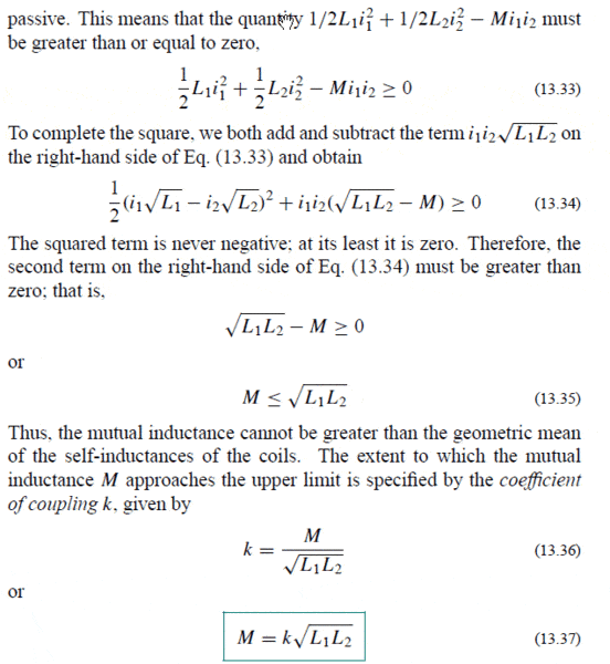

Here it is. I am pleased to say it all makes sense now.
