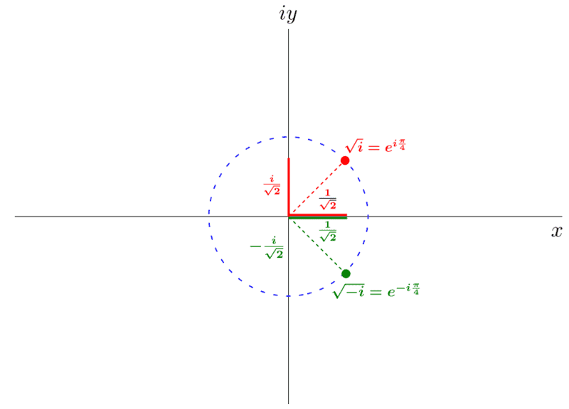

Second Attempt (geometry) : I use the fact from attempt 1 above wherein I showed that ##i = e^{i\frac{\pi}{2}}## and ##-i = e^{i\left(-\frac{\pi}{2}\right)}## to plot the two numbers into the complex plane as shown to the right. From the image it is evident that the imaginary parts of the two numbers vanish when put together. Their real parts however "add up" to yield
So far, I have been able to establish by slightly different methods that the answer to the problem ##\textbf{Evaluate : }\,\boldsymbol{\sqrt{i} + \sqrt{-i}}## is ##\boldsymbol{\sqrt{2}}##. So the answer is a real number.
