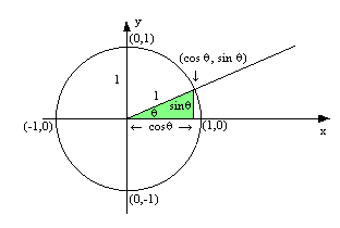

Hi,
I'm trying this summer to finish my mathematical methods book. I'm investigating right now the chapter of complex numbers, the end of the chapter has some applications in electricity and how can complex numbers make the work easier.
The problem is that I didn't found it easier nor reasonable.
I have two main questions. First the book says, instead of writing [tex]I = I_0 sin(wt)[/tex] we can write it as [tex]I = I_0 e^{iwt}[/tex] but we know that [tex]e^{iwt} = cos(wt)+isin(wt)[/tex], so how the imaginary number and cosine disappear?
Second, how that can be helpful for solving problems? any examples?

Complex numbers are mainly used for two purposes:
1) The grid has three phases with the phase voltages: 230/ 0°, 230/ 120°, 230/ 240°. Thus the currents in a 3-phase circuit connected to the grid also have complex values.
If the phase voltage is 230V ( from phase to neutral ), why is the voltage between two phases not 460V or 0V? Try to calculate this voltage by complex numbers.
2) Components in a circuit as capacitors or inductances has complex impedances: ZC = 1/(jωC) or 1/(sC), ZL = jωL or sL. So when you calculate currents and voltages in circuits containing such components, it's much easier to calculate them by means of complex numbers. Your calculator will do the work for you. You don't have to start a fight with Pythagoras, triangle calculations, etc.

still cannot find reasonable explanation for why does [tex]I = I_0 e^{iwt} = I_0 sin(wt)[/tex] it did appeared in various occasions like the some of light waves, instead of using [tex]Σsin(t+nδ)[/tex] we use [tex]Σe^{i(t+nδ)}[/tex]
ahmed markhoos said:
eiwt=cos(wt)+isin(wt)
You are the one, that is right here: ( error in your textbook ).
I0*eiwt = I0(cos(wt) + jsin(wt) )
They used it many times, they ignored the cosine term and the i's. I still don't know way.

In my opinion, it is only a semantic issue. Actually the real a.c. sinusoidal current as time function it is i=sqrt(2)*I*sin(wt+f) where i=instantaneous current value I=effective current value [the r.m.s-root mean square], and f it is the angle at start of record when t=0.
If f=90 then you may present the instantaneous current as i=sqrt(2)*I*cos(wt).
The complex presentation introduces an imaginary part in order to facilitate calculation in
sinusoidal current form [harmonic 1 or fundamental] and forgetting the sqrt(2).
Conventional the real part is connected to cosines and the [artificial] imaginary part to sinus.

The imaginary part of the expression [itex]I=I_{0}e^{i\omega t}[/itex] specifies the reactive current, which must be handled in a different way than the real part - the active current. The reactive current cannot do any work, but is part of the total current across a power grid. That is why you have different values for active power (measured in Watt) and apparent power (measured in VA).

The power is there physically, but integrated as for a period, it will become zero. During the period this imaginary power is integrated to electrical/magnetic energy as for a capacitor/inductance. The current is phase shifted ( 90° ) which leads to that power is going in one direction in one half of the period, then delivered back the next half of a period.
The energy exists ( try to put 10A ac through an ideal inductance = 1Henry, switch of the supply at that instance where the (imagenary) current has its maximum, see what happens :nb) ). To obtain energy, (imaginary) power is required.
