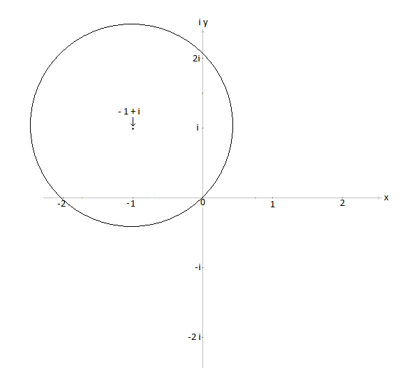

Very well!... it is clear that, since the function ln z analytic in every point of the real positive axis, on it the function is continuous and differentiable. If, therefore, there must be 'somewhere' discontinuity, we can take into account the positive imaginary axis, the negative real axis (as Prove It wants), and finally the negative imaginary axis... there seems no other reasonable choices. Now let's pick a point in the region indicated by Fermat where ln z is 'locally analytic', the point z = -1 + i. Let us look at the following figure...
View attachment 2778In z= -1 + i ln z is analytic, i.e. it is expressed as Taylor series that converges inside a circle and everywhere inside this circle the function is analytic. Çlearly on the segment joining the point z = -1 + i and the point z = 0, the function is analytic, so that the circle of convergence is the one shown in the figure. But within the circle there are parts of the positive imaginary axis and parts of the negative real axis , so that both can not be the 'boundaries of discontinuities' we are looking for. If we develop ln z around the point z = -1-i we come to also exclude the negative imaginary axis, so that this 'border of discontinuity' seems to be a little like the the 'Araba Fenice' ... everyone says that it is but nobody knows where it is (Thinking)...

The basic difficulty here is that "$\log z$" is not really a function at all, in the strict sense of the word. A function by definition must be single-valued. But $\log z = \ln|z| + i\arg z$, and $\arg z$ is not single-valued: it is only defined modulo a multiple of $2\pi$. So if you want to define $\log z$ as an analytic function in some domain, you need to specify which branch of the $\arg$ function to use throughout that domain. In a simply-connected domain like the disk of radius $\sqrt2$ centred at $z=-1+i$, that can be done (in that case, by choosing the value of $\arg z$ that lies between $0$ and $2\pi$), but in a domain that includes a circuit of the origin, it is not possible to give a choice of $\arg z$ that is continuous throughout the domain.
True to the saying of Dante Alighieri I have chosen as signature I decide not to waste any more time on this topic. Sooner or later I will open a math note that validates incontrovertibly the concept I said (Wave)...
