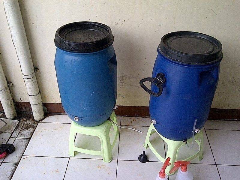

Dear PF Forum,
My church concerns about climate change/global warming condition now. And we try our best to cope (altough in a very small scale) to lessen the effect.
Now, I'd like to know about composting. But I have no idea what to do.
What stages are there in composting
What kind of bacterias are there in bioactive compound involved in composting process.
How to grow/harvesting the bacteria in bioactive compound.
What is the end product and the usefulness of composting end product, etc...

Composting can be thought of simply as the reverse reaction compared to photosynthesis.
Bacteria are using carbohydrates as an energy source and producing Water+CO2+ while releasing energy (as heat).
Composts heaps can get surprisingly hot.

Are you putting the compost product in a kiln to dry it out?
Compost would have anywheres around 40, 50, 60 % moisture.
Too dry and the bacterial action is curtailed during composting.
Too wet and the compost becomes oxygen deprived and you get a stinky - anaeorobic bacteria take over from the aerobic ( aerobic is what you want )

My composting experience is limited to the North Western Europe Climate but i would expect that there are great similarities.
Theoretical considerations aside. When you start to compost you might want to consider practical stuff as well. Such as :
1) Where do you want the use the end products - compost (& perhaps compost leachate = nutrient rich water leaking out of your compost)
2) Is it more practical to compost where you want to use the compost or where you produce your organic waste.
3) Do you have a balanced supply of organic waste ? For optimum results you should strive for a balance between 'brown', fibrous, woodlike materials and 'green' nitrogen rich (mostly food) residue. You might have to bring in dry leaves or some similar material. In urban areas you
4) What kind of stuff do you want to grow in the compost you are using? Flowers, herbs, veggies, rice... Do you want to use the compost as a mulch, anti-erosion, etc...
5) Who does the tending of the mulch heap(s) ? What tools are available ?
6) What kind of pest problems might you have if you make a mistake ?
Most problems will be minor if you take care and you should be able to produce good mulch shortly.
There are a lot of good threads on the internet. Use 'composting in the tropics' for starters. You will find video etc...
You might also want to look at permaculture sites from Queensland, Australia. http://permaculturenews.org/ Permaculture pays a lot of attention to composting and there are a lot of forums where you can get practical advice.

I do composting by using this composter bin.
They say that it's for anaerobic composting.
