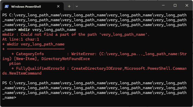

When the total length of the path approaches 260 characters.
I'm not sure what 'the path' means. I Googled it but regretted. I'm borderline tech illiterate, as you've probably gathered.
Does it mean that if you have a folder named folder_1 you've used up 8 of those 260 characters. And a subfolder named folder_2 you've used up 8 more? If so, would that mean you could have 30 or so nested folders before it became problematic?
In Windows (which is the only place it matters) it means you have used 12 C:\folder_1\.
9 more: folder_2\.
Yes but that doesn't mean nesting folders that deep is a good idea - it would be impossible to keep track of what is where.
Also note that working close to the 260 character limit is not a good idea - let's say you want to take a backup on another disk in the folder "D:\backups\pbuk-laptop\2024-10-16T09:09:23\" - that's another 43 characters added on the front (guess how I know this).
