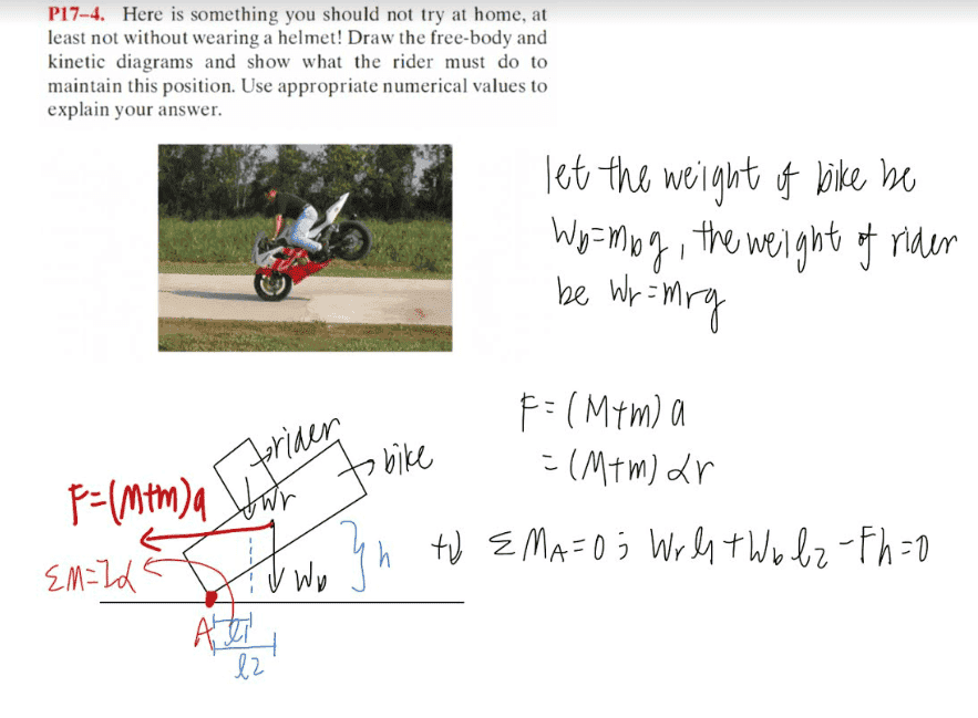

(Conceptual- Planar Kinetics) How to maintain the position

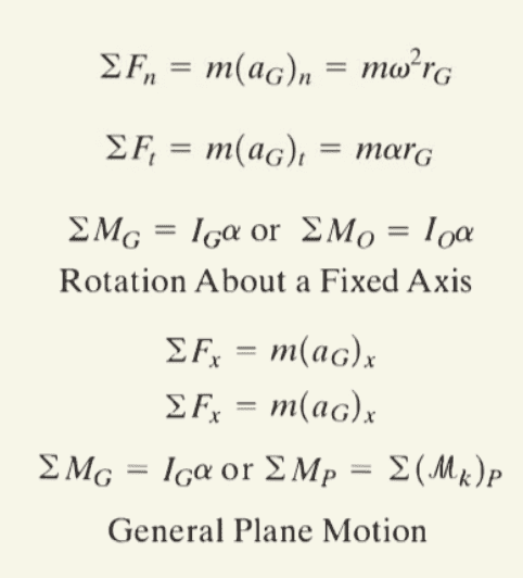

Relevant equations :
List of planar kinetics equations: sum Fn = m(aG)n = m omega squared rG; sum Ft = m(aG)t = m alpha rG; sum MG = IG alpha or sum MO = IO alpha for rotation about a fixed axis; sum Fx = m(aG)x twice; sum MG = IG alpha or sum MP = sum(Mk)P for general plane motion.
Handwritten free-body diagram of a wheelie bike: tilted bike and rider with weights Wb and Wr, force F=(M+m)a, moment equation sum MA=0 with labels h, l1, l2 and point A on the ground.
Kindly advise whether this approach is correct, I am not sure whether the friction force should be considered.

You can consider a combined center of mass, rather than one for bike and one for rider.
The actual location of that CM is more or less by the knees of the rider.
The contact patch of the front tire can be considered a fulcrum.

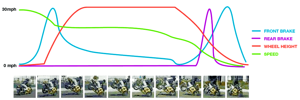

The front brake is working, the bike is deccelerating and there is a horizontal friction force vector at the contact patch, pointing rearwards.
For a short period of time, there are two moments in perfect balance (zero angular velocity):
1) One is clockwise and is induced by the vector weight times horizontal distance between CM and contact patch.
2) The second one is counter-clockcwise and is induced by...
Line graph of a motorcycle wheelie stoppie: front brake, rear brake, wheel height and speed plotted against time, with a strip of photos of the bike below. Speed falls from 30mph to 0 mph.
