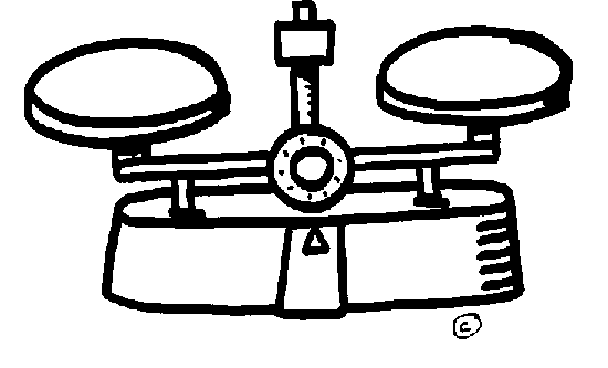

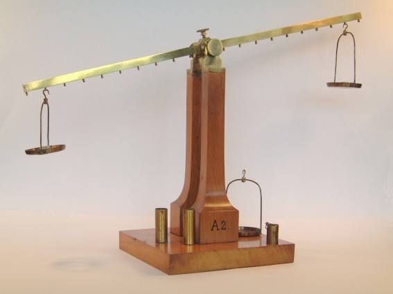

Now imagine the two identical objects are not floating, but hanging on a scale like this:
Your water and glycerin are in buckets standing on a scale like this:
Both scales are initially balanced. Then you submerge the objects into the buckets, and they do not float, but submerge fully (without touching the walls).
Does the balance of the scales change? If yes, how?

Hmm...that's a really good question. I would think that the balance of the scales would not change. This is because the displaced fluid from the fully submerged object does not escape from the buckets and thus, the mass in both of buckets remain equal when the objects are added. This is just my thinking though. Is this correct?

Consider the buoyant force on each submerged mass. Is it the same for each?
Try to figure out the upper scale first, where the objects hang, and consider what DocAl said.
